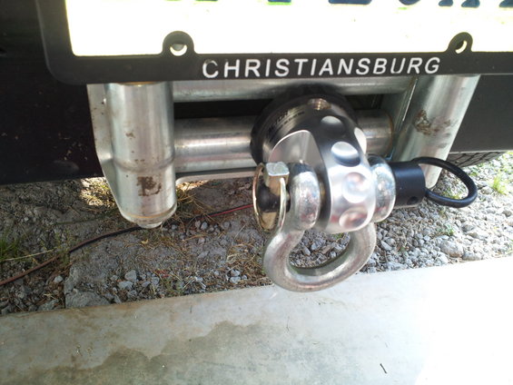

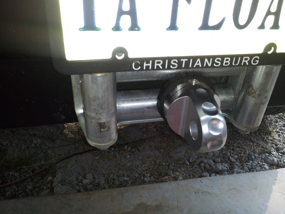

Picked up a cool new hook for my winch cable. It works with a standard clevis setup.
It will work great with my quick release pin and clevis I made to use on the rear receiver .

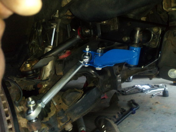

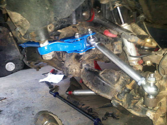

Finally going back together with the upgraded steering. Parts came in quickly , I cannot say enough about my first impressions when I opened up the box.
The TC system is BEEF !! Welds are beautiful , fitment is fantastic !
The center link, pitman arm and idler arm are bare metal on arrival so I had my buddy powder coat them.

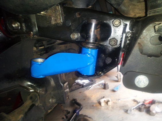

Kit reuses the stock idler arm bracket with a really nice gusset.
Beefed up replacement pitman arm.
This is as far as I got today. Still gotta torque everything down, finish reassembly, string alignment and get to a shop for a computer alignment.

Wow that's REAL beef. That looks like quite the upgrade in steering.. enticing to do, but for that price they didn't powdercoat it for you??? Yowza.
How was the install?
