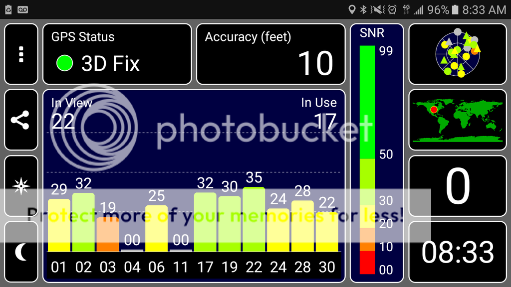

Ok so I had been using my LG G-Pad to test out some of the different GPS apps - Maps.Me, Backcountry Navigator, Orux, etc. I was having problems with the GPS basically not keeping up with my location. I especially noticed it in Maps.Me since I'm using it for general nav purposes.
Basically if I'm driving down a road the pointer icon on the screen would only move every five or six seconds and doesn't accurately reflect my location. It might even show that I'm driving down the sidewalk, or on more than one occasion it told me I was driving the wrong direction on the interstate. Thinking the G-Pad was taking a dive I tried using my Note 7 but it does the same thing. Poor location tracking, slow/laggy refresh. The screen will randomly rotate as if I've suddenly changed directions, even if I'm driving down a straight stretch of interstate. I've tried restarts, uninstalling and reinstalling apps, factory reset in the case of the tablet, nothing seems to work.
I'm just wondering if anyone else has had this issue and possibly found a solution. It seems to be an issue with the internal GPS and I'm almost wondering if I need to switch to an external GPS receiver like the Dual or a Garmin Glo. I've not read any complaints of this from anyone else, though.

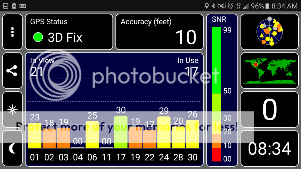

I haven't downloaded the test app on the tablet yet but I did put it on the phone last night and tried it out this morning. These screen shots were taken with the phone mounted on the dash, no case, just the mount. The truck was sitting in an open parking lot with no obstructions and a clear view of the sky.
