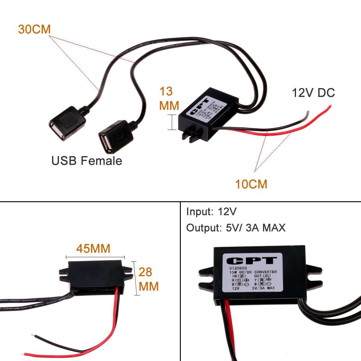

You probably need a step down voltage converter DC/DC for 12v to 5v. Your tablet uses DC so converting 12v DC to 110AC to 5V DC is kind of a waste and very inefficient. The charging issue is not from the power source, it's the amount of amps that device will allow to flow. Phone chargers are typically only rated to 1A draw.
Photo below is of a device that does this I just pulled off Amazon. I need a few of them but have yet to locate one without quality issues and complains of them either giving dirty power or not meeting the rated amp output. Perhaps your luck will be better, honestly I don't need it at the moment so I didn't keep my head in it long enough to find what I need.
Any USB plug that can output 5V/2.1A should keep a tablet happy. I don't know if higher amp USB power sources are available, the one shown claims 3A.

Or you could just pop a Blues Seas or Marinco USB adapter into an existing cigarette lighter socket.
He wants an in dash install if I gather the OP right. I doubt he would want to run a cord out from behind the dash and tie up a externally accessible 12v port. It's just not clean.
That is why I suggested the DC/DC converter, it hooks up to hot and ground, and for the same cost as a 12V pigtail and a plug in adapter that could rattle loose back there, and wiring he already has to do, it's a cleanly installed, small USB power source that could be installed in the space behind the dash.
