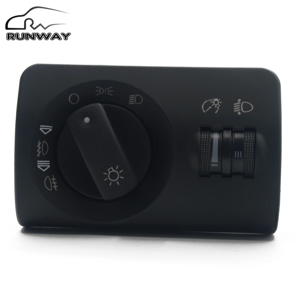

My plan is to wire these up to the rear foglight function of the headlight switch. Yeah, it's a little weird, but Audis of this era (not sure if they still do) came with one rear fog light built into the taillight housing, as it is apparently a requirement in Europe. We don't have much use for that here in the states, so I thought it would be more useful to control my offroad lights, and keeps everything clean and OEM feeling inside.
The way it works is you turn the headlights on by turning the switch all the way to the right, and then you can pull the switch out one notch for the fog lights, and then pull it out another notch for the rear fog light:
New-Fog-Lamp-Headlight-Control-Switch-Leveling-Black-Fit-For-AUDI-font-b-A6-b-font.jpg
That will be pretty slick to control the offroad lights as well once that's hooked up. The other thing I need to address is that the plastic that the light mount is bolted to is not very solid. It's fine for now, but it will not stand up to any real abuse, so I'll need to reinforce that with some sort of home made bracket from behind the bumper cover. It will be super easy to do, I just need to take the cover off to do so, which is a bit of a pain. Oh well, I need to take care of a few other things while that's off anyway, so it that will be done then.

I would advise against using the rear fog option for the lights. They only are activated on low beam as far as I can remember with my Passat. If that is the case it goes against what the hellas are for. I would wire using the high beam circuit as a trigger for the hellas and put them on a switch as well. So you can run high beam, and high beam with the hella. I have never used mine with low beam. Makes it easier too if you run back roads in the night with minimal traffic, you can just flick your high beams and have instant daylight and down to low when traffic comes your way without hitting any extra switches etc. Makes more sense to do it this way.
Hmm, OK you're right, I tried it, the rear fogs do turn off with the high beams. Damn.
I just run my Hellas off a relay so they always come on with my high beams. No extra switches to worry about, no running wires through the firewall.
The reason I don't want to run them with the high beams is because in California uncertified off-road lights need to be covered when on public streets. That would mean that anytime I want to use my high beams, I would either be running the Hellas with the covers on (and potentially melt them), or I would have to go uncover them. Neither are what I would prefer.
I'll have to do some research and see if I can either disable that feature in VCDS (there's all kinds of crazy stuff you can do) or wire it differently so that the rear fogs are not disabled with the high beams. Otherwise I might have to wire up a separate switch, which is not something I wanted to do, because I wanted to keep the interior as OEM as possible (besides a CB or HAM radio that I was going to install).
Thanks for the insight, guys. Back to the drawing board.
