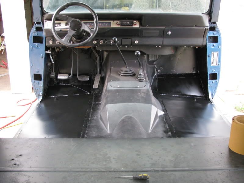

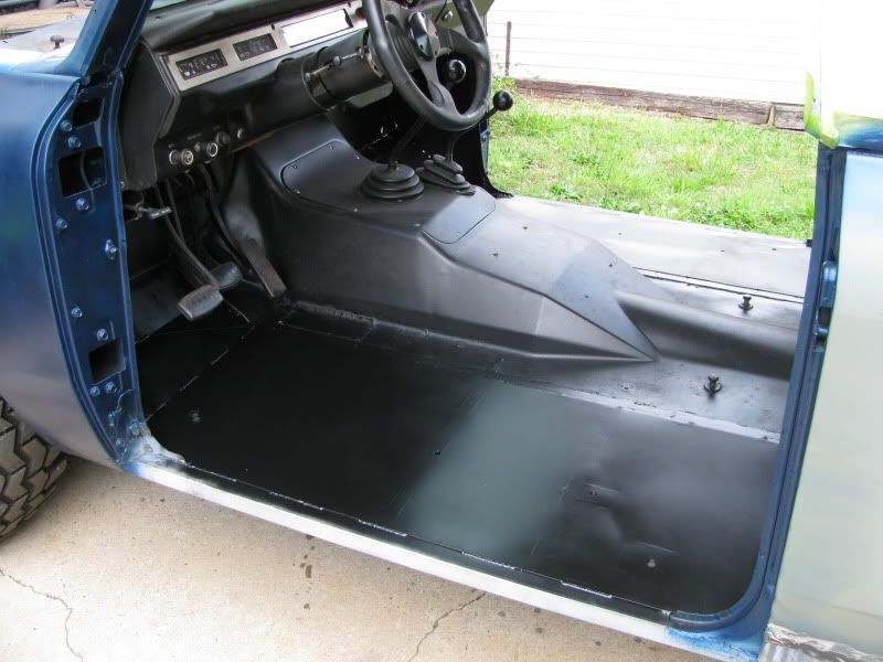

new floors in:
seats and center console all in (interior is done for now):

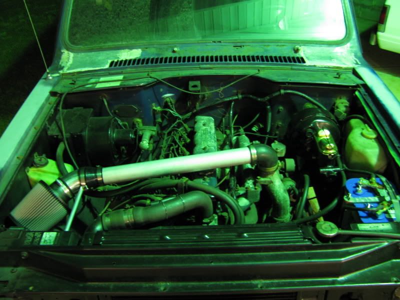

new air intake and engine bay is done for now:

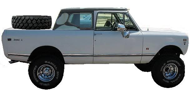

Alright guys, so bear with me on this one...
I got to thinking about room inside the scout and where equipment would go, etc, etc and I had an idea.
Plenty of people have taken the fiberglass tops (like the one on my traveler 118" wheelbase) and shortened them to fit the scout II wheelbase models. It ends up looking pretty cool with the slanted back hatch as compared to the scout IIs squared-off top.
What Im thinking of doing is sort of a variation/reversal of that. Im thinking of taking a scout II top (which is steel and much easier to alter than the fiberglass, for me at least...id rather weld than do fiberglass work) and shortening it and making a double-cab sized top for the traveler, leaving me a short truck bed behind it.
Here is a crappy pic I worked up in MS Paint to illustrate what Im talking about:
There would be a bulkhead built into the back of the traveler separate the inside from the mini truck bed. I would also incorporate a hinged cover over top of the bed for a tire to mount (though it might impede my rear-view a bit...but Ill cross that bridge when I come to it.
The beauty and advantages of this setup are that I could still fit 4-5 people in the traveler, a rollbar could still be mounted inside (unlike with a short cab top), the rear seat can fold forward for storage inside the cab, equipment/fuel/compressor/air tank can be put in the bed safely without being IN the cab area, the top would be lighter and therefore easier to take off than a full-sized top like I have now, and it would just be something different and cool that I really havent seen before.
The actual shortening of the top would be easy enough and they are pretty easy to find and usually really cheap.
Let me know what you think.
02TahoeMD
First, about the doors - running doorless is seriously cool, but I will definitely fab up some kind of open frame / bar or whatnot to give a bit of structure to your side in the event of a collision. I remember driving my 73 Bronco once without the doors and while it was fun....I felt a bit paranoid being that exposed. Alas, that was MANY years ago.
Second, your design is a pretty neat idea. The only detriment it could be for you is that it would limit your ability to carry large cargo when the need arises. But, if you already have a pickup or large van then that is a moot point. Would definitely be a unique look! And that is a good thing. :smiley_drive:

Yeah, I am picking a set of doors up from a friend in a few weekends that will be going on for the time being. Also, Its likely I will make a set of tube doors as well to use if I take the doors off in the summers.
Eventually I want to have super scout II door inserts added that use soft doors, like this (though I will retain the hard top):
And I will put reinforcements similar to this under the door inserts:
As far as the cargo area is concerned, yes I have a pickup, this is just a secondary vehicle for me. Also, I have plans for a trailer down the road a bit, but I dont think I should have problems. I can always add a roof rack, not to mention the long top that is on it now will be able to be put back on whenever I want...so I will have options.

Do the Travelers have the regular Scout tailgate mounting points, and can that hardware be bolted in place and still allow the Traveler hatch to function?
ExpoScout
Yes, the travelers have the same mounting points, so a Scout II tailgate will bolt right up.
As far as the hatch working in conjunction with the tailgate, Id either have to cut the hatch in half so it would mate up with the tailgate, or simply take the tailgate off if I wanted to put the traveler top back on.

They stretched a Scout II 1/2 cab. Aren't those fairly rare? I know the Terra's short cab is more like the Traveler than the Scout II's roof.
I don't recall the details of the Scout II hinge and latches. I was thinking more about being able to leave them in place than the whole tailgate.
