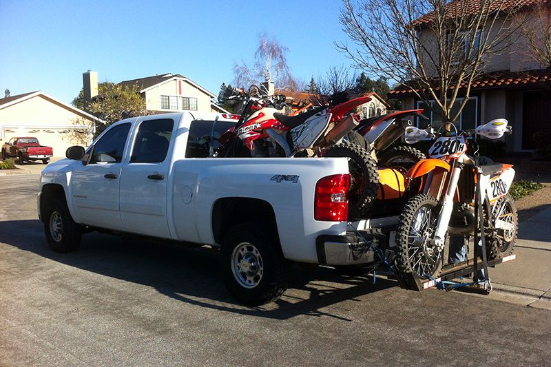

Time for some updates on this rig.... the truck was sitting not driven for a handful of months while I explored a couple suspension options plus I had a number of other projects on my hands most of 2013. I finally started driving this truck a few months back and with things starting to level out I have the itch to set this rig up.
Here is a pic loaded up full of dirt bikes

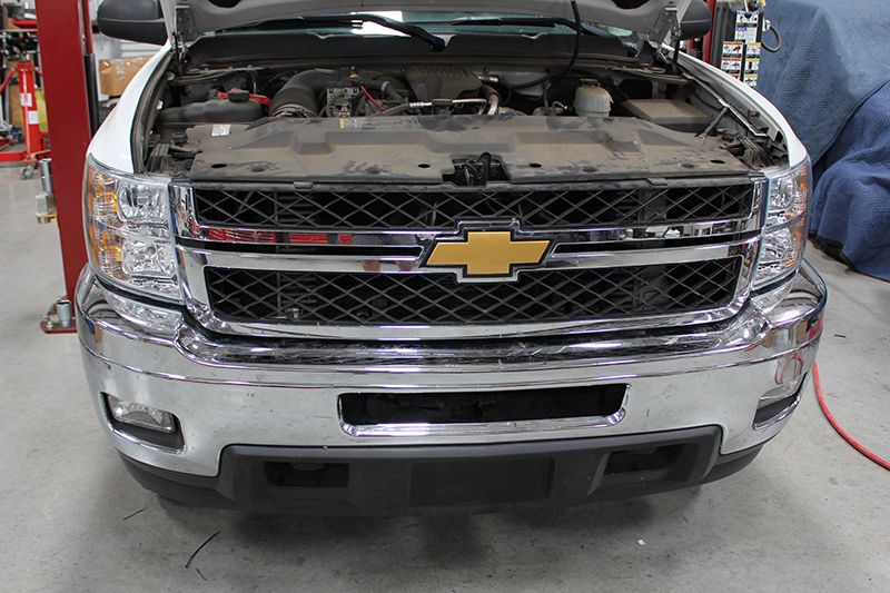

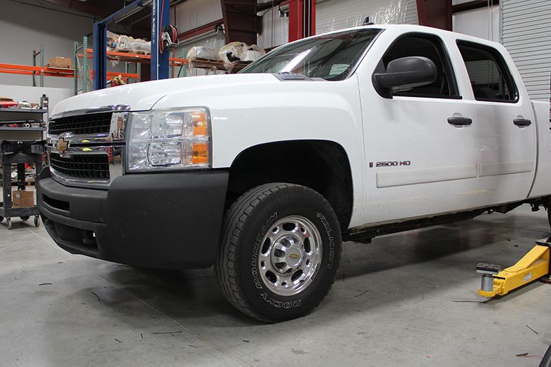

So far the truck has just over 100k miles and runs like a champ, but the tires needed to be replaced so I decided to do a 2011-2014 Chevy face lift:

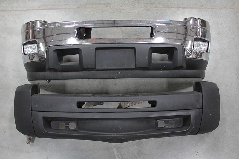

A 2013 Chevy front bumper was used, looks alot nicer compared to the 2008 style
When using a 2013 bumper you can simply bolt the 2013 grille up aswell.

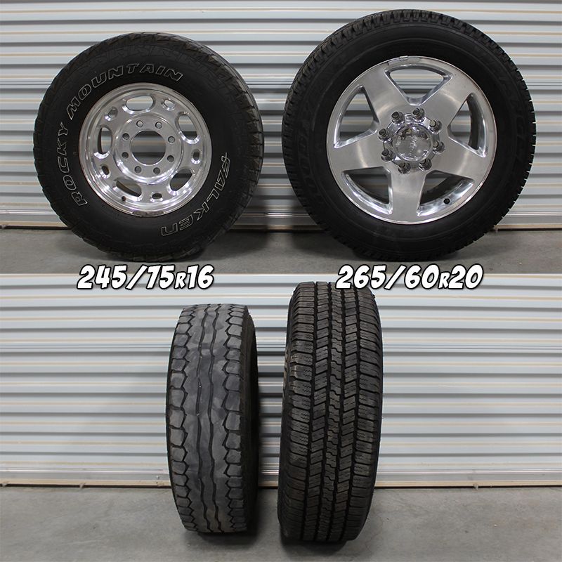

Along with the bumper and grille I added a factory set of 20"s I snagged up from a GMC build I did a while back.

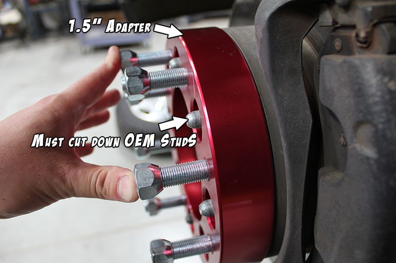

If some of you know that the 2008 wheel bolt pattern is 8on6.5 and the 2011+ wheels are 8on180, as you can see I used an adapter to convert the bolt pattern, also with the newer wheels having a deeper back space I wanted to equal it out so the tires didn't "suck" in. I used a 1.5" spacing front and rear.
End result was less than a days worth of work and a 2011+ look

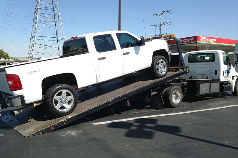

I say the truck has been great to me, only letting me down once so far........

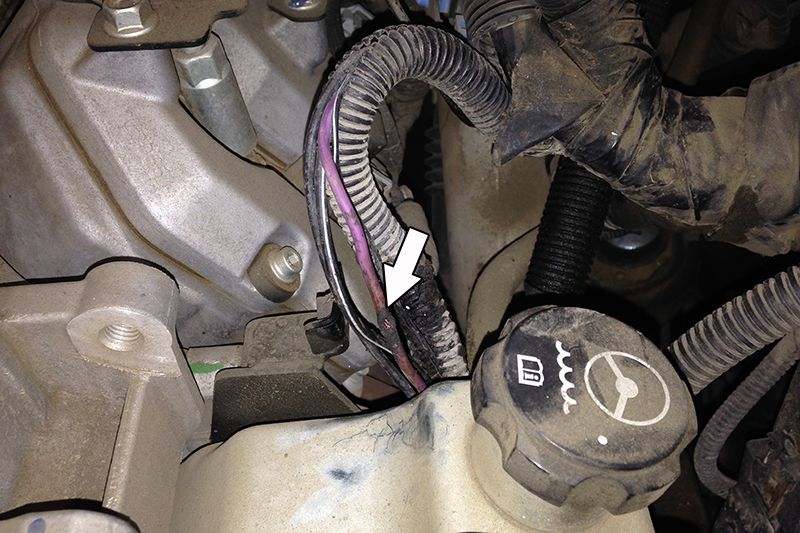

Normal day driving the truck in town on a hot day, I stop to grab a drink and come out of the gas station and the truck will not turn over. I looked at all the simple possibilities but everything checked out other than a ignition fuse had popped. I though maybe started, did a bunch of searches on line and started a post on the Duramaxforum FaceBook group and after a few hours of frustration I track down this.....
Behind the power steering pump the starter ignition harness had rubbed through and ended up grounding out the hot wire to the starter :( Easy fix once found.

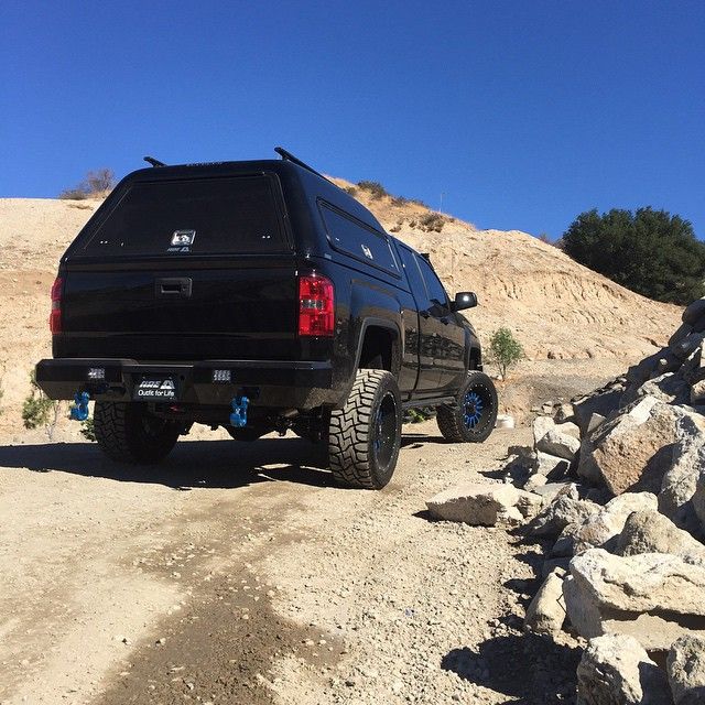

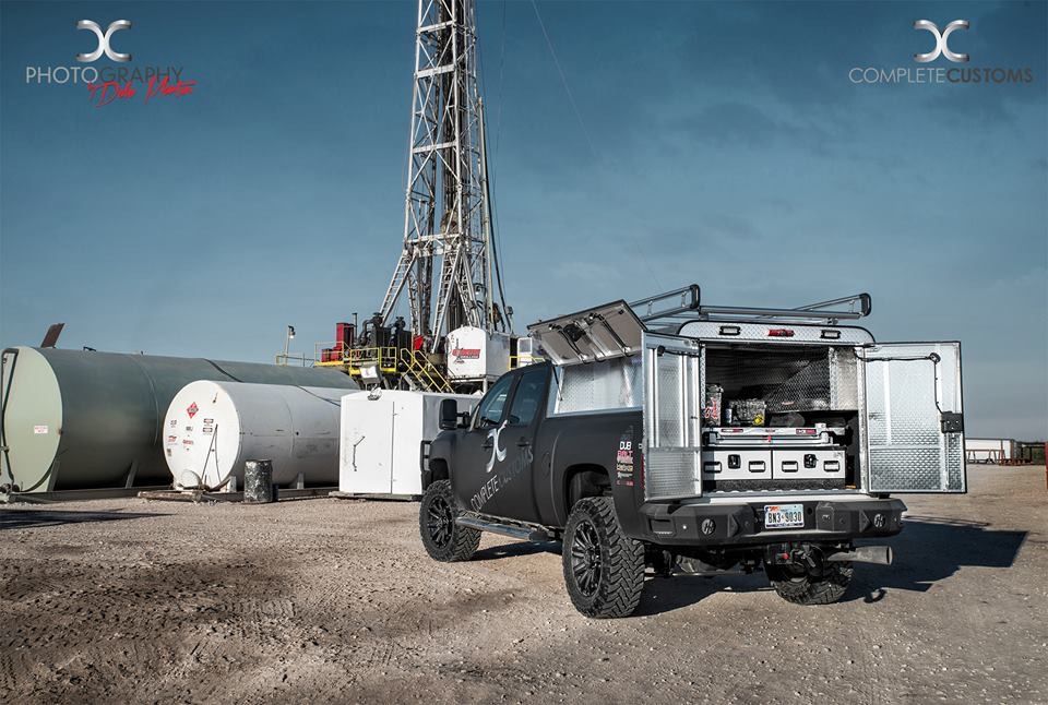

I have talked to ARE truck tops a few times now and I am pretty sold on going their direction for a bed top. Whats everyones thoughts on between these 2 styles of tops? I am not sure what I like better.
surlydiesel
I like keeping my tailgate when I have a topper on. It's always my go to work bench, seat, bed extender, step ladder and the list goes on. So, I vote "contractor" style with the side doors and keep the tailgate. Otherwise, the barn doors look cool but I would prob miss my tailgate. I've never tried it but that's the gut feeling I have.

I like the first cap with the barn doors. I have a leer 180cc similar to the third picture and I'm looking at getting rid of it for an aluminum contractor unit or a "spacekap" fiberglass module which are hard to find, and harder to find at a decent price.
I'm really interested in the 8x6.5 to 8x180 adapter. Wondering who makes them and if they are available in 2". Thanks.

I agree on the "work bench" and I felt I would miss it so I am looking at a bed slide unit also. My thoughts are I can stack more up front and keep the tail end more free or where I can have things I would be using out side of the truck and then use the slide as a work bench when needed. I am leaning on ditching the tail gate because I hat leaning over it in to the bed.
I'd highly suggest looking at a place called Feds Spacers or > http://www.wheeladapter.com/
The once pictured I had problems with the studs and had to change them out already. You get what you pay for I think the saying goes lol
