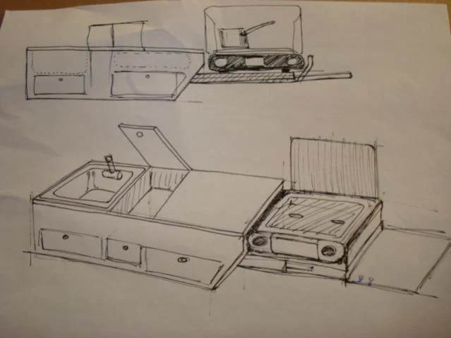

Here is where I am heading... I've been working on another round of mods on my trailer... the kitchen is 2nd on the list!

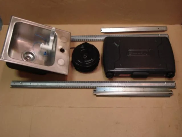

So I have decided on a design, thanks for all the imput everyone. My biggest missing link was deciding on whether or not the $$$$ involved in heavy duty drawer slides was worth it or not. Well, I was surfing on Ebay the other day and found a supplier getting rid of HUGE 48" full extension drawer slides, for $30 bucks a pair! I couldn't go wrong, so I ordered two sets and they arrived this week. I am stoked- they are not as nice as some of the accuride models but they are amazingly beefy for my needs!
Here is a rough sketch of what I plan on doing for the slide out kitchen. I will have a sink, faucet, stove, cutting board, extendable shelf, storage for pots, storage for utensils and other items too.
I plan on using polyethlene (cutting board material) to create the entire counter top/work space. It is anti-bacteria absorbing, easy to clean, sanitary, stable and easily worked with my tools. I will pick up the sheet I need early this week and start the build.
I am going to do one of two things with the sink (craigslist $15 find! ). I will either cut out the existing holes and reweld the edge of the sink back on making a square mounting surface, or I will open up the 3 holes into one elongated rectangle and fill it with a "pocket" that can store towels, soap, dish brushes, tooth paste, things like that.
I will have one counter accesable hatch that will store the pots and pans and other things that will fit, maybe some plates and the coffee press.
The stove is a cheap-o Coleman, that I can find replacement parts anywhere in the country. It will be bolted down to a slide out underneath the counter and will house its own slide out shelf for all the things we seem to keep out while cooking If I have learned anything about using my trailer it is that EVERY horizontal space in the trailer is usually in "use" before we depart from camp.I feel like this is creating the space I have been longing for. That in combination with a fold out table, and I should be all set... for now
The kitchen slide out will be roughly 14" tall, leaving me at least enough room for 2-3 four inch tall drawers for storage.
Overall, I think it will be really nice. I am going to build the kitchen first then I will know exactly what is needed inside the trailer to make it work dimensionally.
