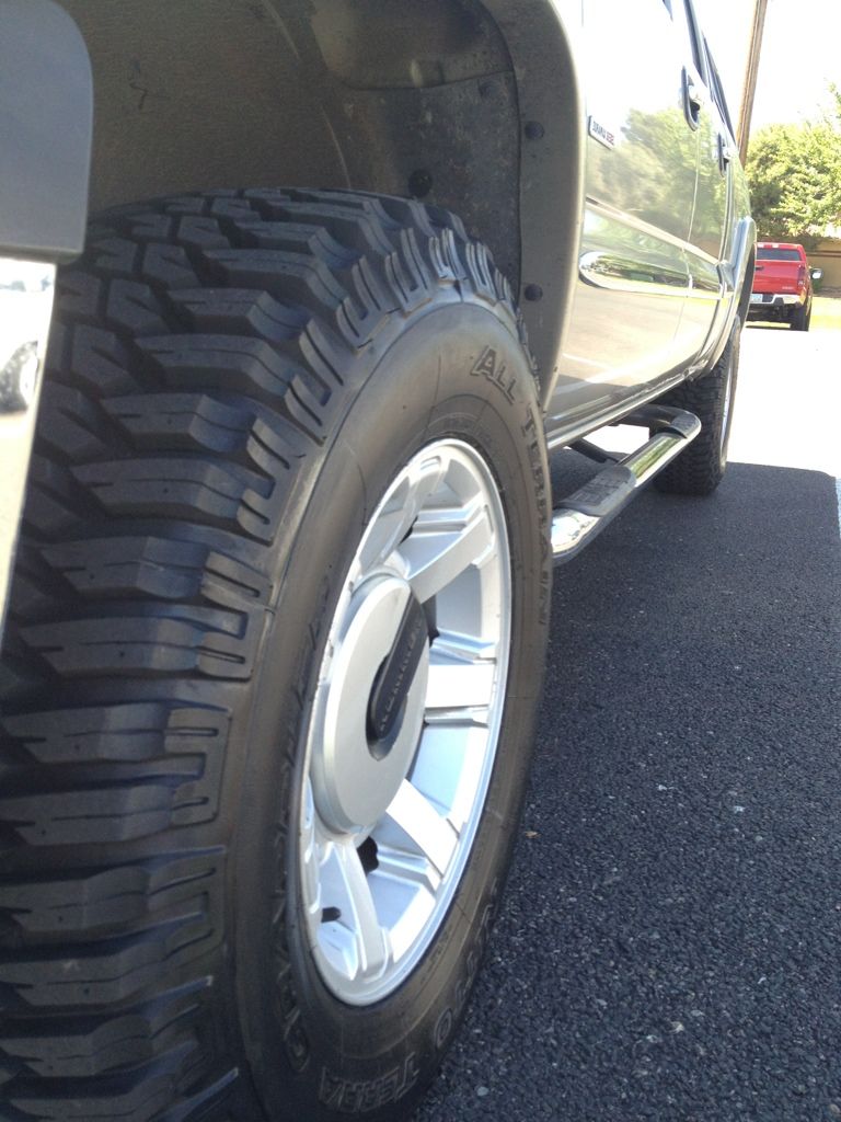

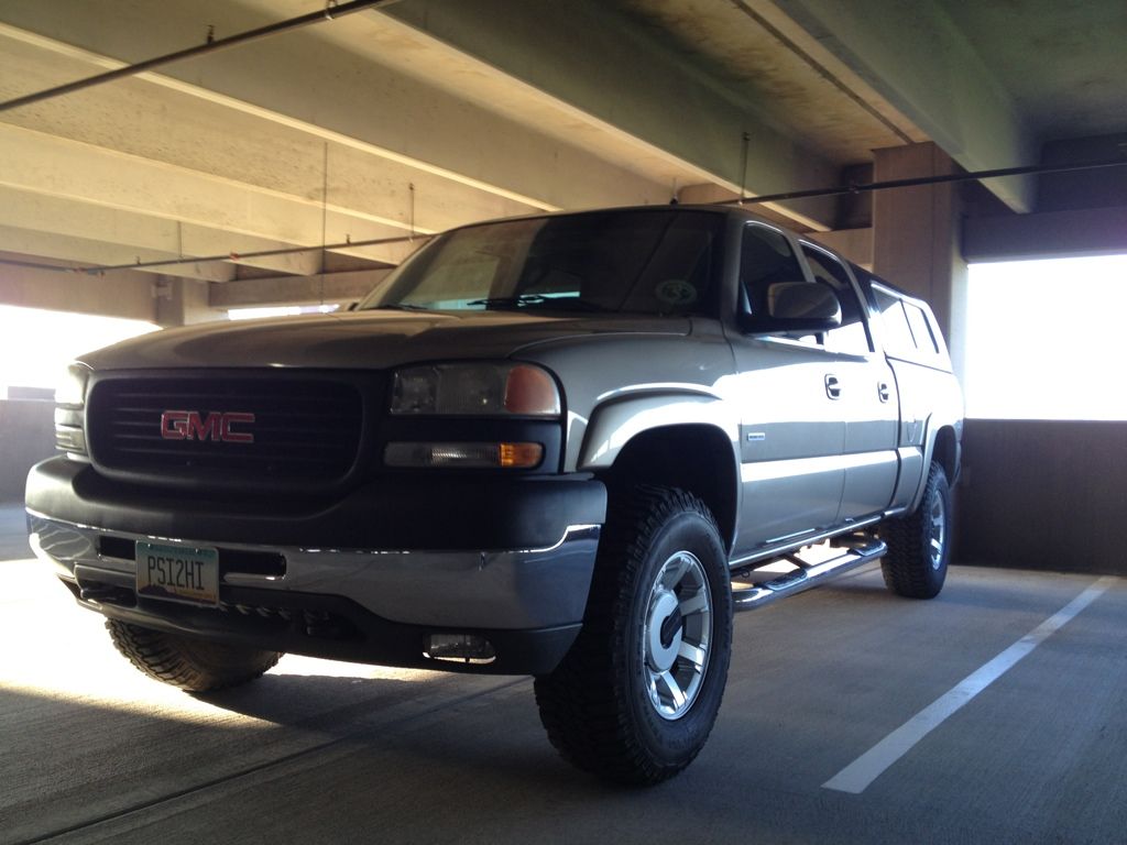

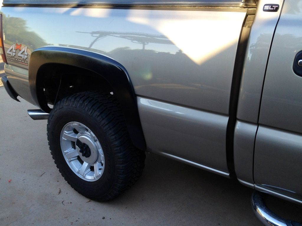

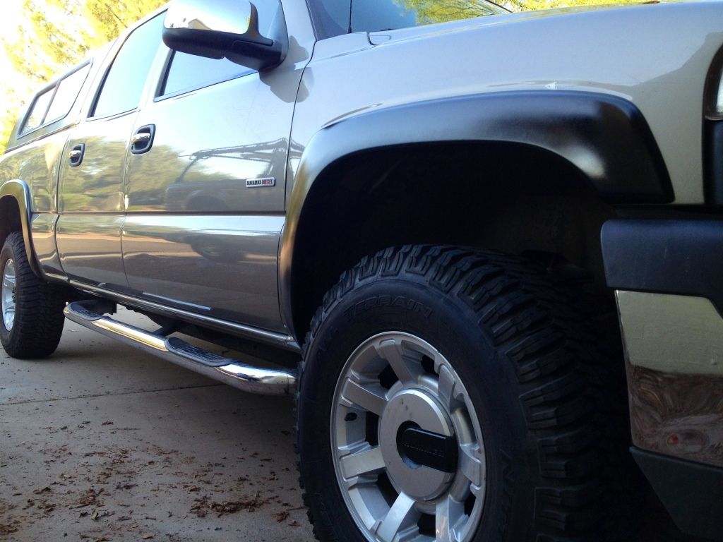

Got the tires installed today. Balanced very well. Casings (Nitto's) are from 08 and the look great.
DoMiNiC1
Update.
Put around 600 miles on the tires. They are smooth, and a remarkably soft ride for an E-load tire. Tire noise is audible at highway speed but only with the radio off and window down. So far so good. :elkgrin:
DoMiNiC1

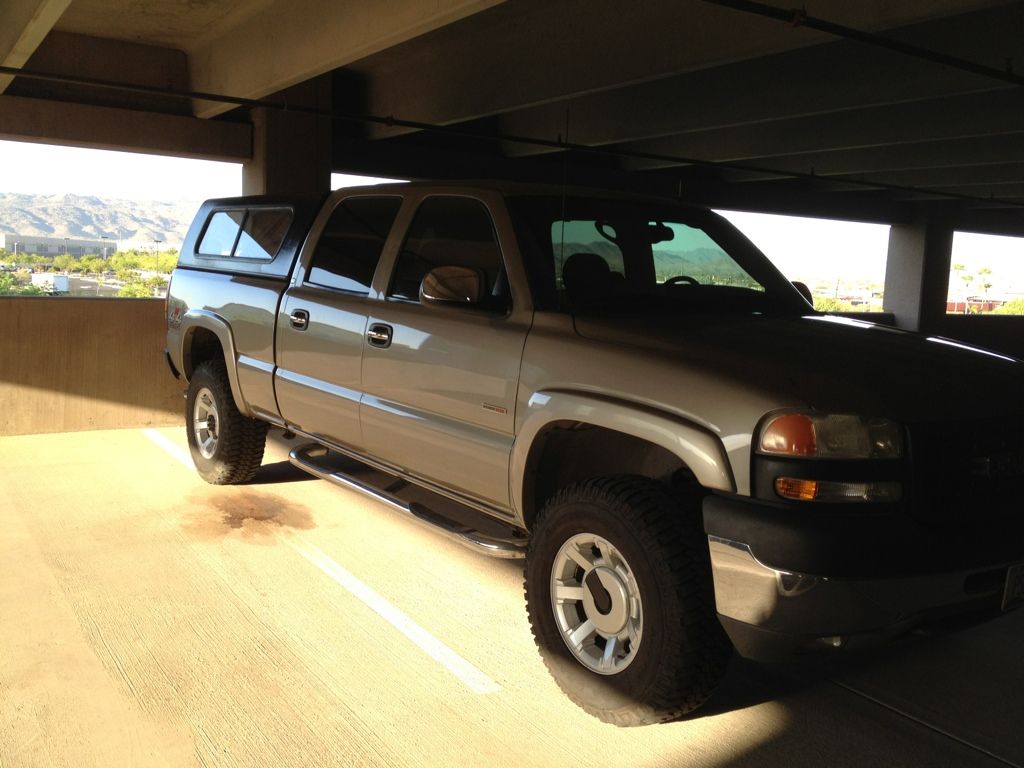

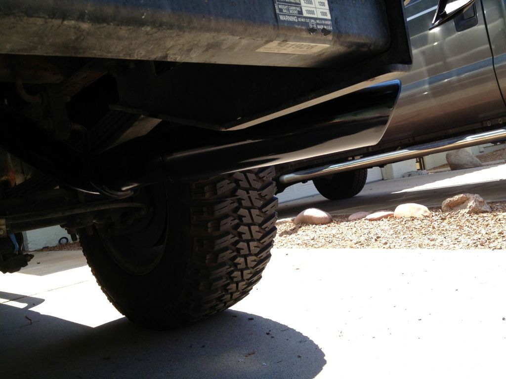

So I Have but around 5k on the tires and they are holding up fine. I also picked up a 5 hummer wheel so I could mount my spare. The spare will not fit under the truck, well if fits but there is only a paper thin space between the diff and the tire, the tow hitch it too beefy and takes up too much room.... I may need a 2in lift to fit it under.
The truck seems to love the bio-fuel mix form the truck stop, runs smother and combustion does not sound as "dry". I also run an additive.

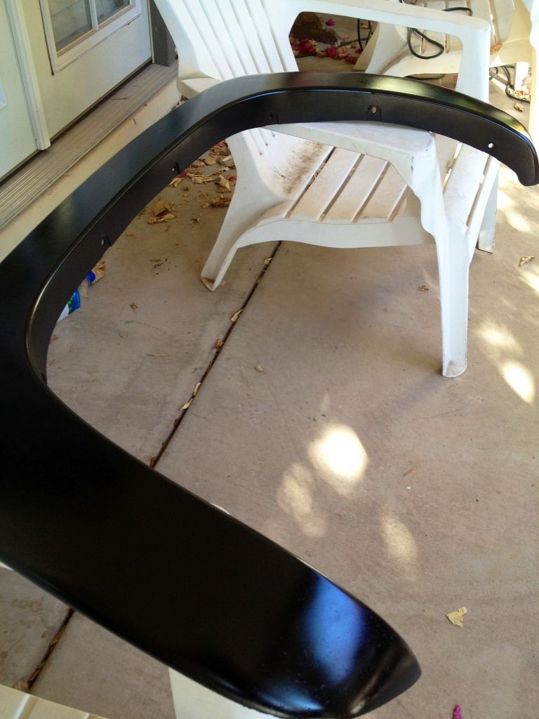

Looking good. So when do the H2's get the treatment?
I can't decide whether to go with a liner on the bottom of mine or try one of those wraps that would cover the whole side and I could have fun with.
Jack
DoMiNiC1

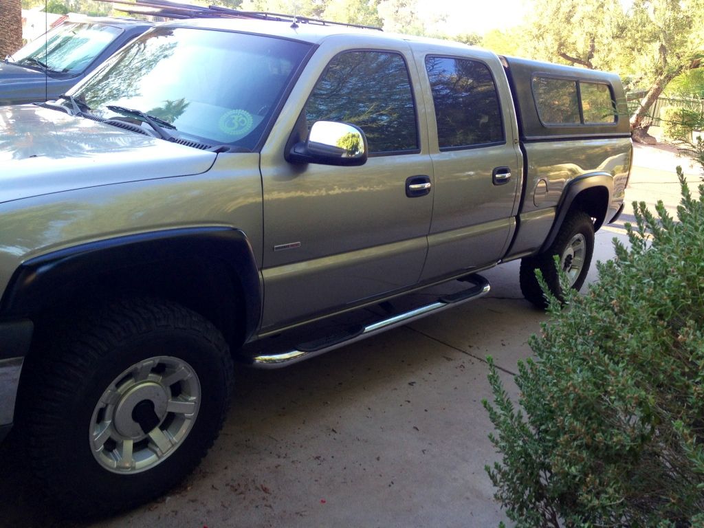

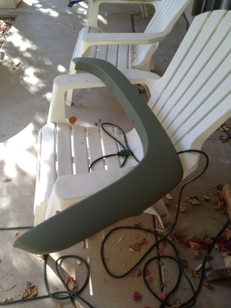

H2's will be next, then some all black towing mirrors, also going to paint the chrome exhaust tip black with some flat engine paint. A wrap would be awesome, but the rubberized liner would hold up longer I suspect.. I have also been thinking about painting the fender flairs black.:coffee:
