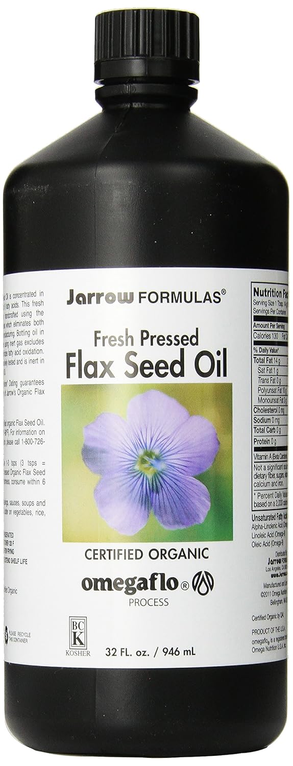

I think you guys let your flax oil go rancid. I keep mine in the refrigerator and I have never had a bad smell when seasoning my pans. Also make sure it's 100% pure flax oil with no additives.
I use this one from Amazon.com
http://www.amazon.com/dp/B0013OUK6Q/ref=pe_175190_21431760_M3T1_SC_dp_1
