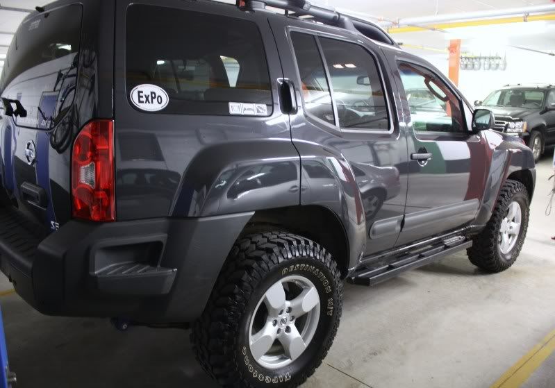

Rev's 2008 Nissan Xterra SE

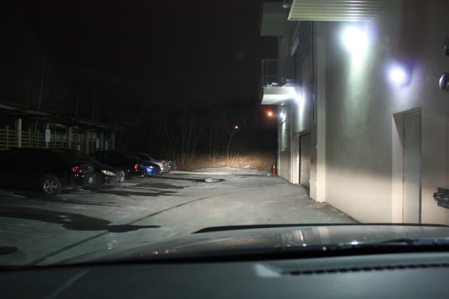

Wired up my Daylighter's today on a Fangars cage. They look really good.
Crappy parking garage shots wired up
hood glare is minimal

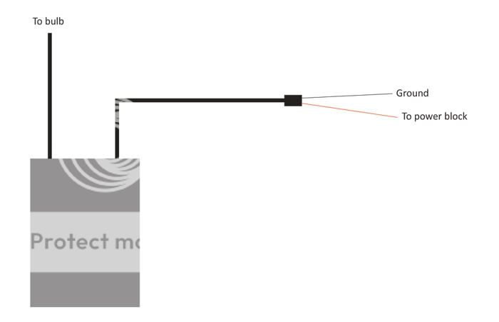

The Plan
The above two pics are care of cynicroute http://www.thenewx.org/forum/showthread.php?t=25207

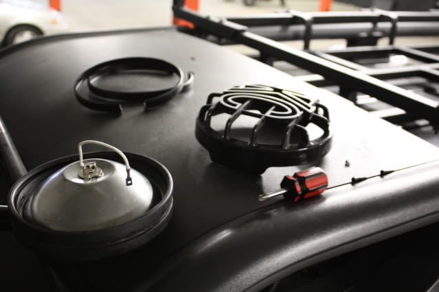

Begin by unscrewing the clamp that holds the glass on to the light. (I removed both screws but I’m not certain this is required)
Remove the glass and unclip the power wire.
Unscrew the ground and remove.

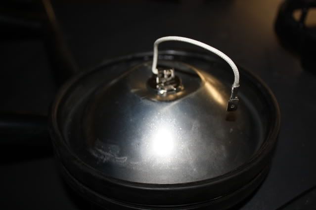

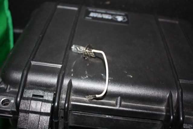

Lift up the tab and pull out the old bulb
Rev

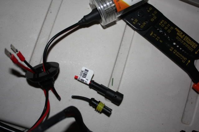

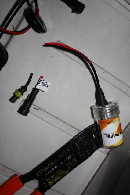

Cut off all the nonsense
HID bulb. Do not touch!
Set the new bulb in and center it up.
Replace the screw and push the tab down
Crimp on new connectors

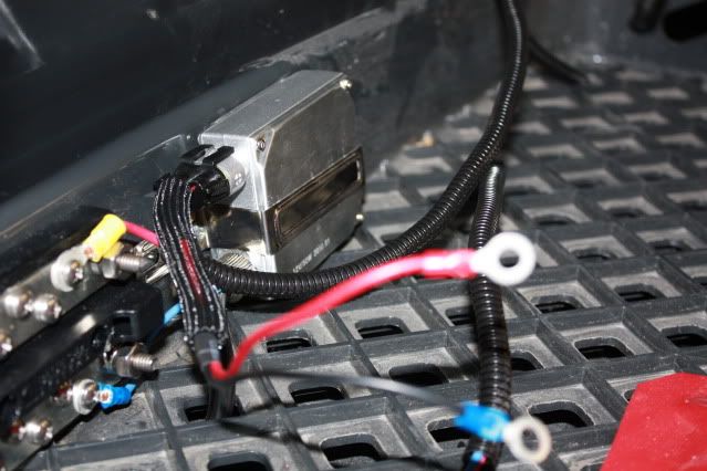

Mount the ballast:
Rev
Power and ground of the ballast to the distribution block
Connect your +and- wires from the ballast to the lights (soldered and shrink wrapped)

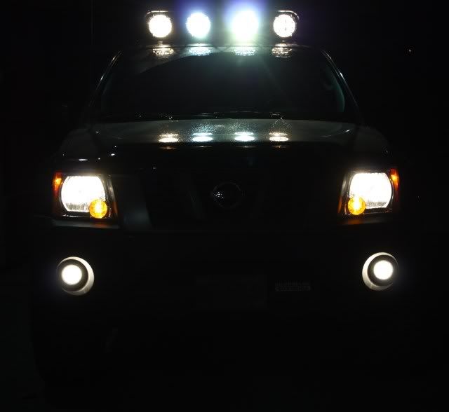

Night shots
smart

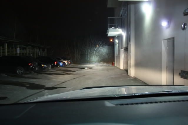

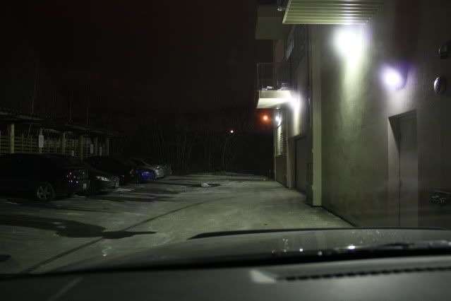

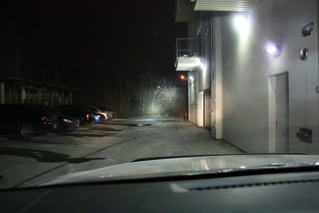

no lights (other than the loft's lights)

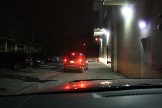

lo-beams (no fogs)
hi-beams
hi's with roof lights
Rev
lo's with roof lights
just roof lights
The trees are about 100 feet away. The hill is about 15 feet high. The lights are not aimed, but they are amazingly bright. Even brighter in person. Great mod for $50! Can't wait to try them out on a dark country road.

Thanks!
Oh ya, the HID lights are far far brighter than the halogens. I also like the white light's output far better. The halogens seems so yellow now that they could be fogs, ha!
I turned them on in the city last night and they were lighting up overhanging tree limbs and street signs a block away with nice crisp light.
