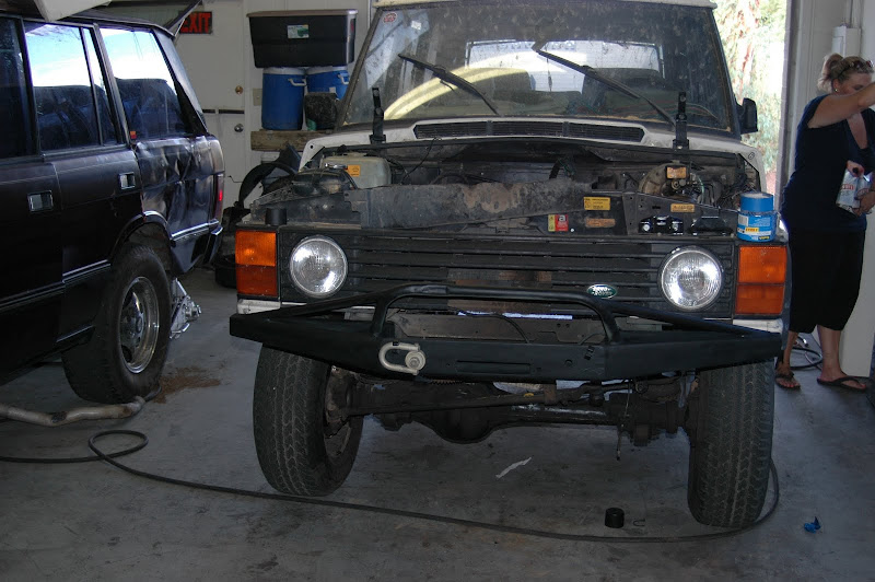

I guess my first post wasn't too clear... We have the '87 that was involled in a front end collision, and my wife and I decided that it good for her brother to learn general mechanics by repairing it. So we went and got him the '90 RRC, to steal the hood, and front clip off of it. A few days after we got the '90, we saw Graham was selling the '89 Chasis and Body and decided to do the jump. And thats how we got to where we are now.
So we decided to make a Franken-Rover, and we played the name to make Roverzilla. End goal is to have the 3.9l with the LT230 and ZF Auto in it. Since we got it with the lift, rack, bumpers, and sliders, after tires and the swap we should be pretty close to good to go on the mechanical issues. We will be taking the best of the three parts for interior parts, and hoping to have a decent rig at the end.

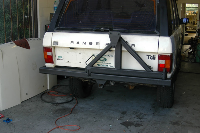

With the frame clean, FlyingWen got to some exterior cosmetics in painting the bumpers, and sliders. I filled in the holes that were drilled for the tow bar, and some other random holes on the rear swingout, and she went to painting.

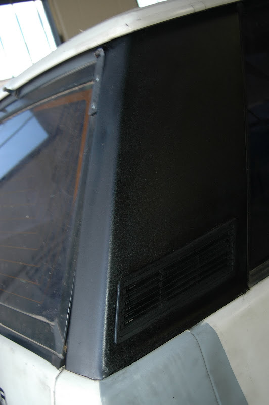

We tossed around ideas on what to do about the D-pilar vinyl on the RRC, and we decided to peel the vinyl off and coat it in bed-liner rather than mess with all the other issues. Looks pretty good, but we'll see how it handles the dust.

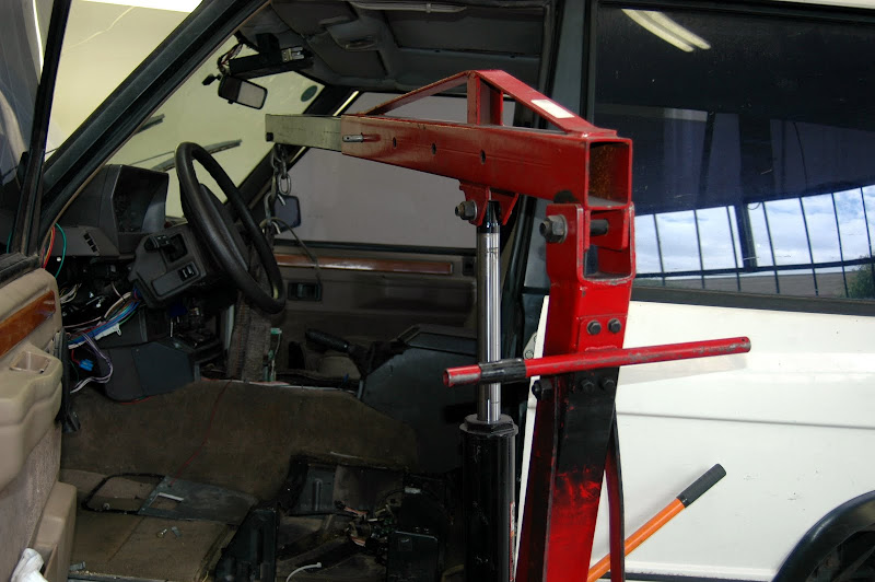

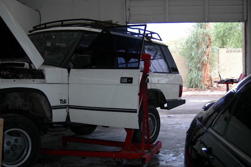

Just a quick update. The engine swap went well, and we put in the 3.9 and this past weekend got the ZF and T-case is finally mated up behind the 3.9. This has been one heck of a learning experience for Dusty, and FlyingWen too. So at least this project is well worth it just for that.
We cheated and used an engine hoist to mate the transmission, skipping the transmission jack all together.
I only read this this morning. Funny you should mention that, because I was thinking something like this myself as I was struggling with the transmission jack last night!
