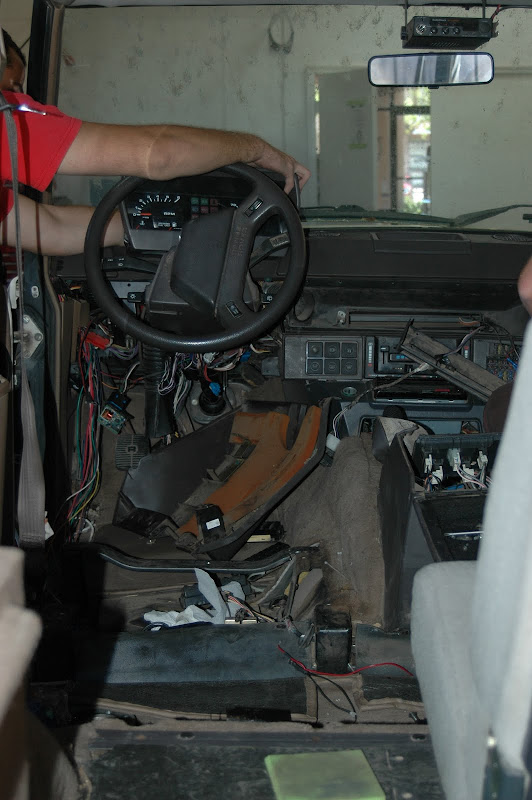

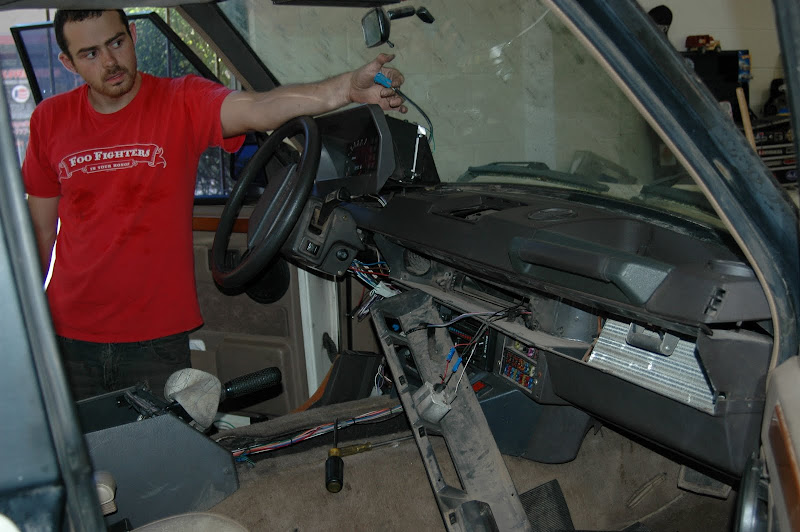

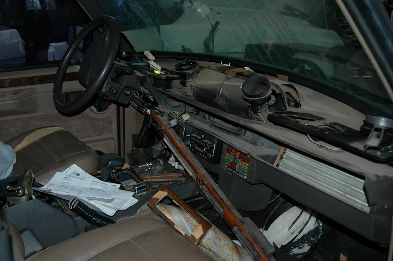

Top dash, coming out of the '90 and getting put into roverzilla:
Seats, and majority of the interior out of the '87 transferred:

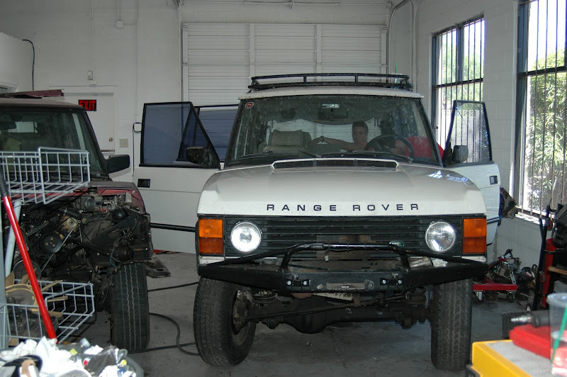

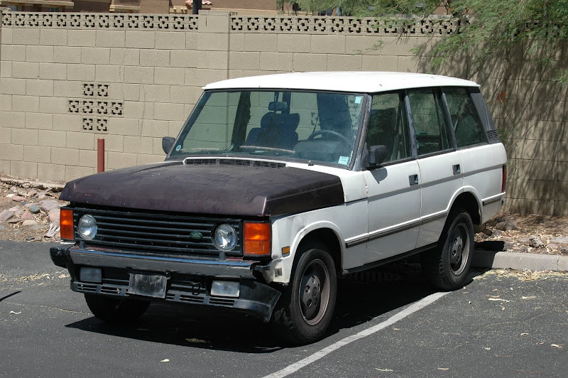

'87 repaired good enough to get out of the garage:
We're going to steal the brakes off of the '87 for Roverzilla as the '90 has an electrically boosted brakes. The 3.9L, and ZF Auto Tranny out of the 1990, and the LT230 should go into Roverzilla this week.

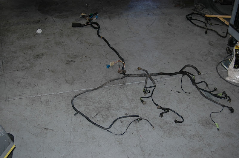

3.9L Engine Harness
Dusty got the 3.9L Engine Harness out, and working towards removing the engine and computer..

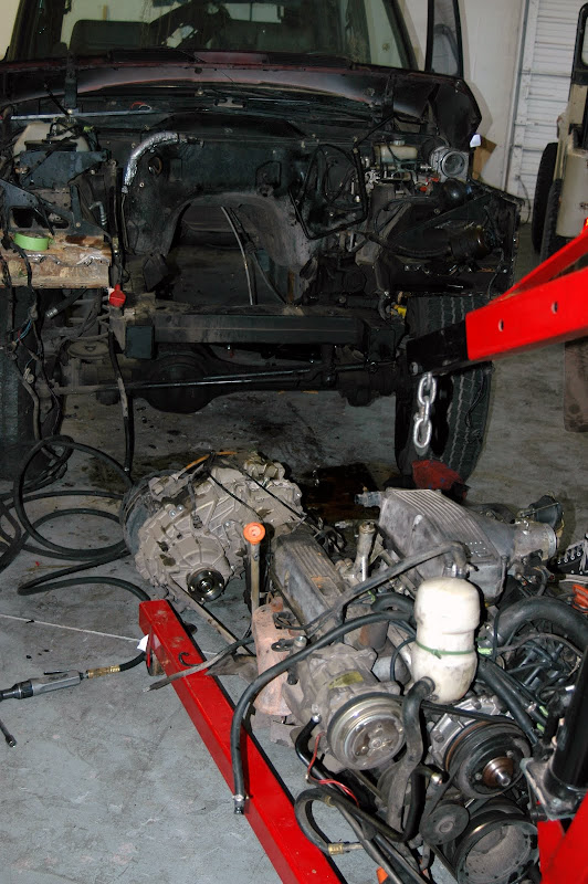

3.9L is out... Just removed the BW Tcase, and pulling the LT230. Next we need to weld in motor mounts for the 3.9, tranny mounts into Roverzilla.

Making Progress. We got the LT230 out and mated to the new drivetrain, brake master cylinder in, and started on prepping the frame for motor mounts.

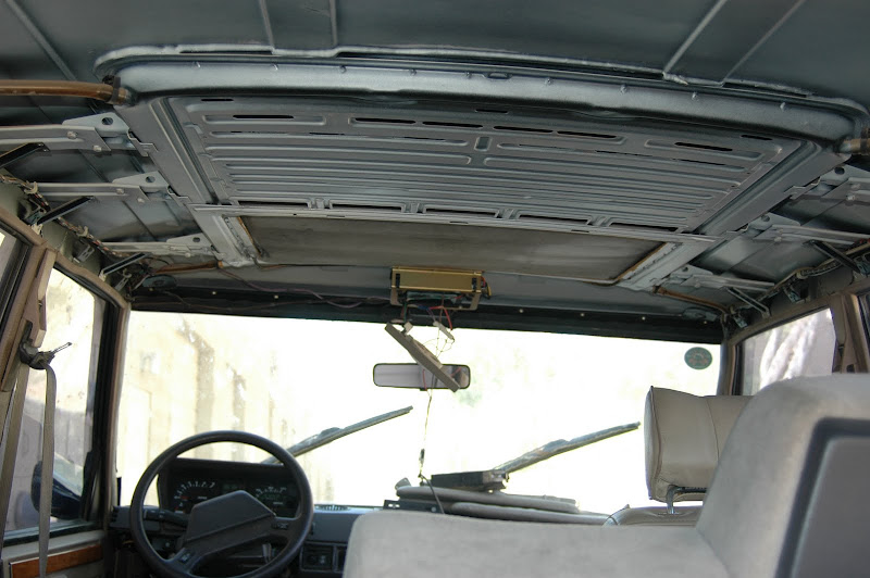

Flying Wen got the headliner out..

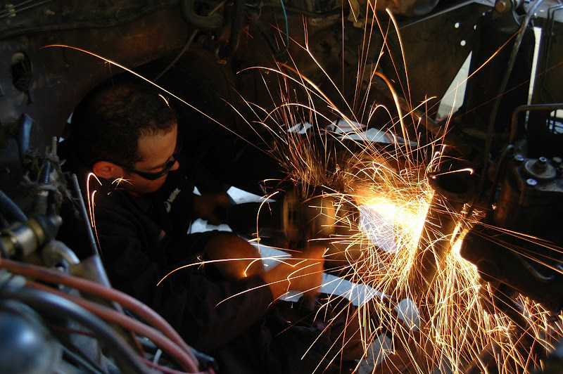

Dusty prepping the frame and cleaning up the TDI motor mounts:
Dusty in action:
Its all fun and games until someone's belly hair starts on fire.
