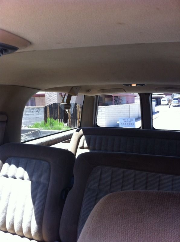

lol i thought i had posted a pic but i guess not. Heres a few, the guy was older and just used it to tow stuff so he kept is completely stock and clean, exactly how i like to buy vehicles. Needs some work, brakes need to be done, a few random sensor codes and some little stuff but after a little time i think it will be great.
