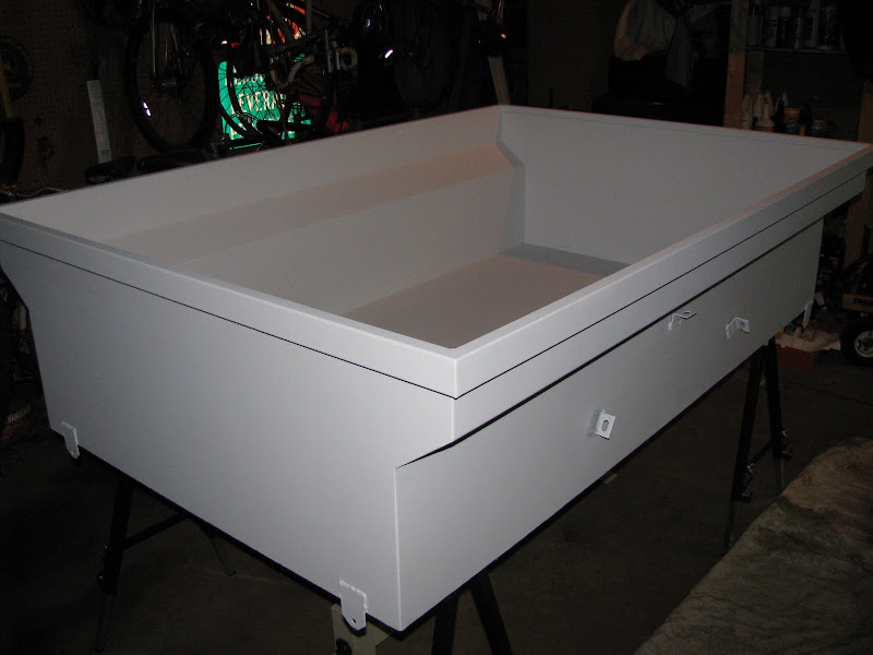

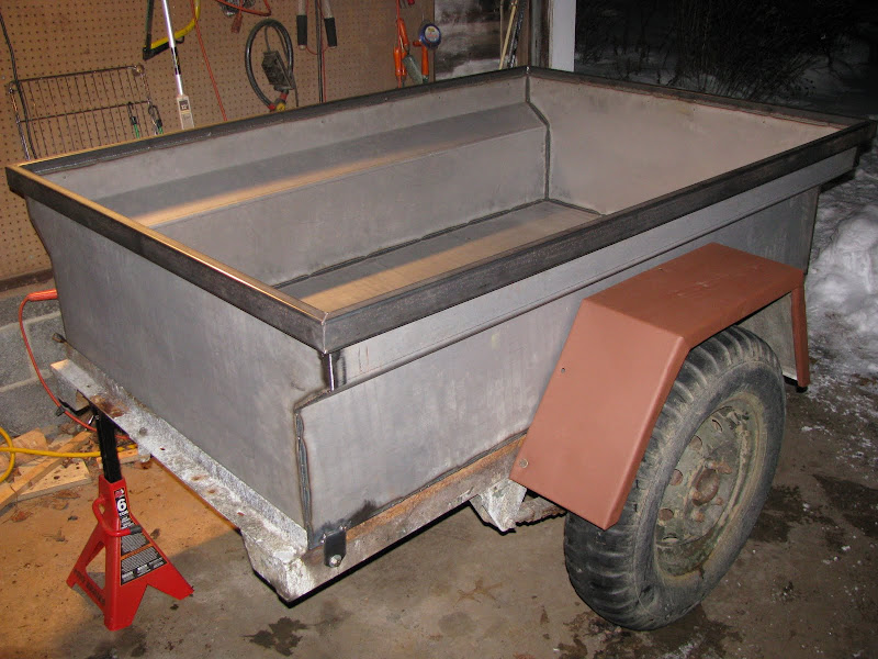

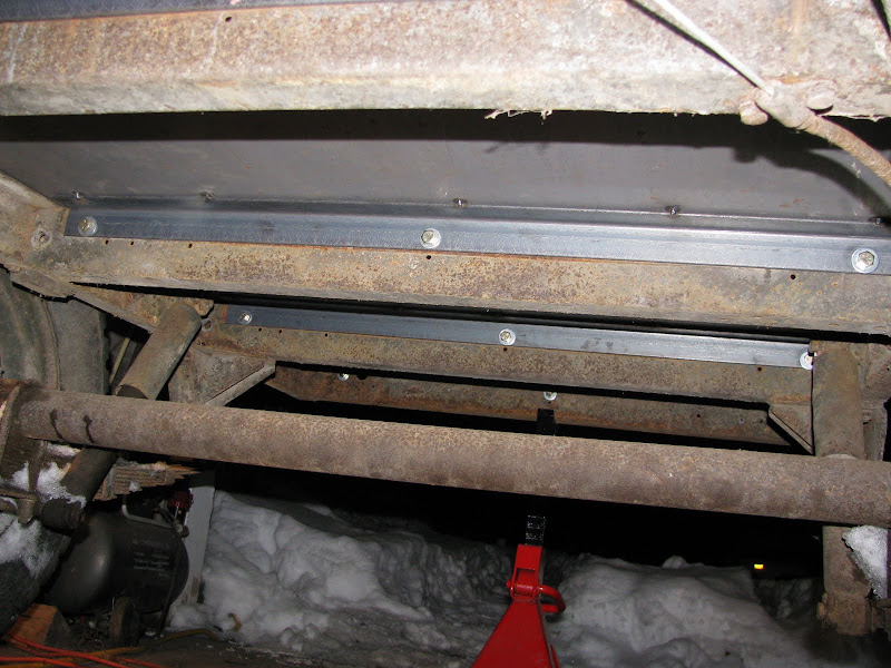

I sat the tub on the frame for the first time today in order to tack the brackets that hold the tub to the frame. Here are some pics :)
Next step is taking the frame back off, finish welding, grinding all the corner welds and on to primer. Also, its time to start sanding the frame and painting it.

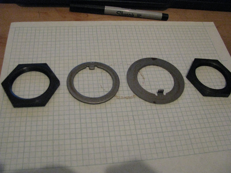

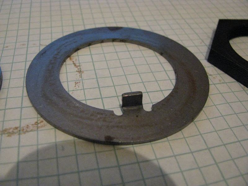

I got the nuts and washers for my hub assemblies in the mail today from army jeep parts. Thanks for pointing me in the right direction OverlandXJ!
Can anyone explain to me the order of nuts and washers? When I took apart my hubs, I only had one washer, and it was between the two nuts.
This one was not on there

I found this diagram in a service manual for the M416 that I found.
I am assuming that the larger of the two washers goes next to the bearing in spot 10 and the smaller one goes between the nuts in spot 12. The manual is not specific about which is which. They are both called key washers.
It is the smaller one that goes against the bearing then a nut, then the larger washer, then the last nut. After you have the bearings tightened done to where you want them, take large screw driver, and bend one or two of the edges outward. Then take a punch and bend it down against the side of the outer nut. That locks it in place.
Hope that helps.
sgv209
Hope that helps.
Thank you, that's just what I was looking for!

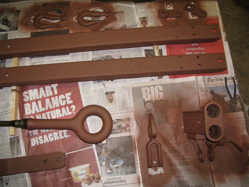

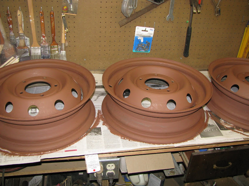

Progress has been slow, unfortunately. The frame is now completely apart and I have primer on the wheels and tongue assembly.

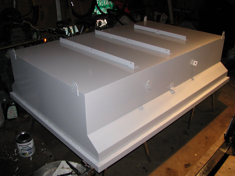

I will be picking up all the grade 8 hardware for the trailer tomorrow as well as primer and paint for the tub. I have changed my mind on color and am going with a black frame with a white tub to match the jeep. I also plan to put herculiner on the inside of the tub. I am also ordering reproduction NDCC tires early next week. The ones that came with it were extremely dry-rotted.
sgv209

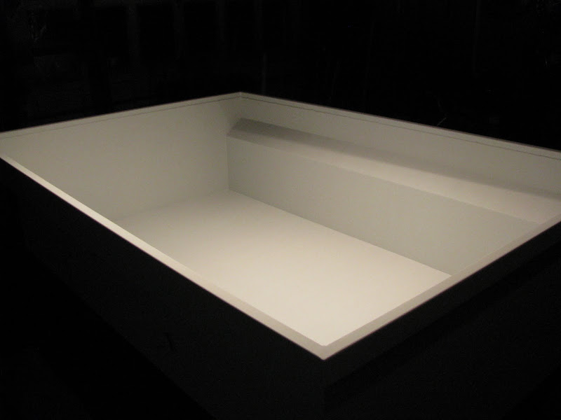

I've slowly been wire-wheeling, grinding, sanding and painting. I got the tongue and wheels painted, and the first coat of primer on the tub. Hopefully I can get some paint on it this week, and get the rest of the frame stripped.

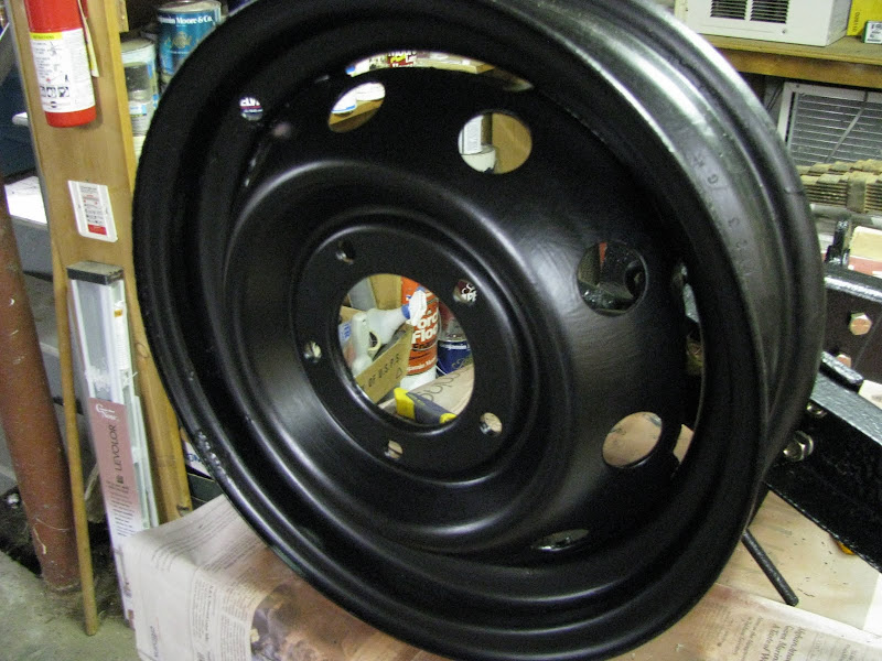

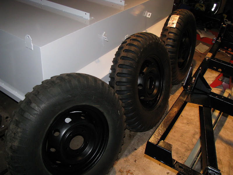

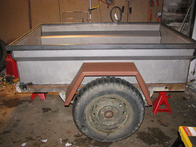

I got the frame and tub painted, and it should be rolling sometime this week :wings: I also got the tires in the mail and mounted them.
The two on the right are brand new, and the one on the left is the spare.

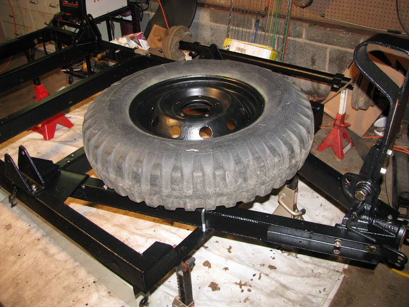

I was thinking of mounting the spare below the tongue like this to keep some tongue weight on the trailer at all times.
Does anyone have any suggestions for a good way to attach the spare? I have seen a build where they used a tire carrier from a pickup truck but I don't remember where.
sgv209
Thanks Detour. Looking at that location more, it seems that the spare would interfere with both the parking brake and the landing leg.

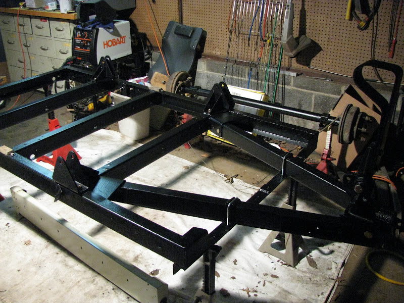

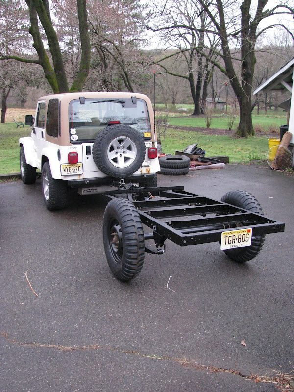

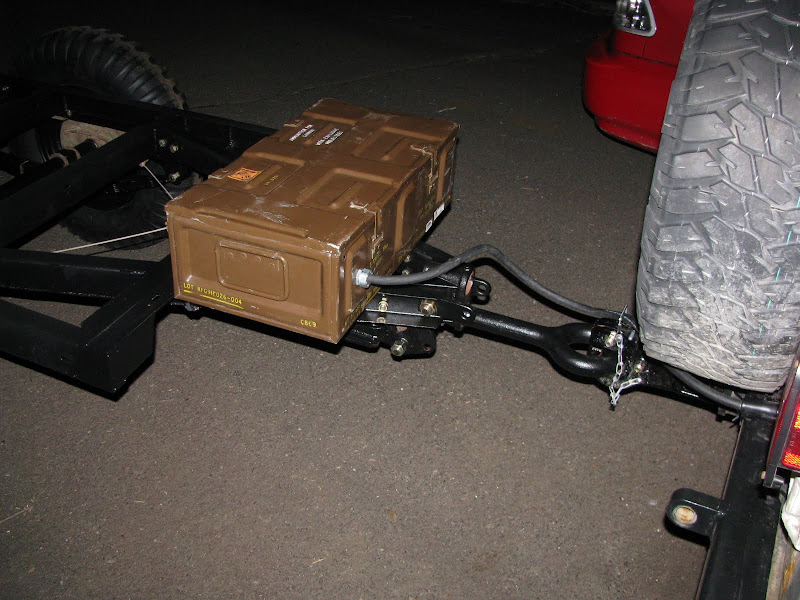

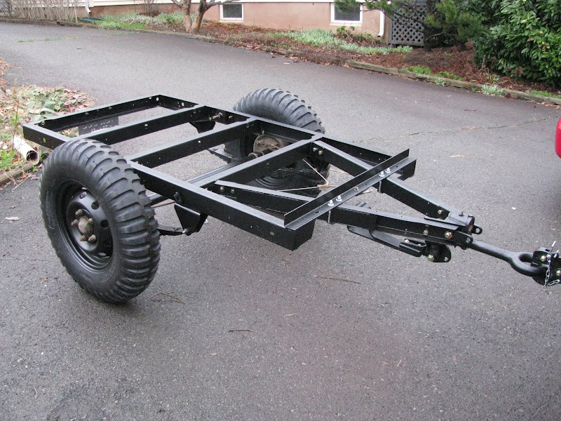

Today, I got the frame all together and the next step is wiring. I have an 81mm mortar box coming in the mail to be used for a tongue box to house the wiring connections.
Here's a before shot of the frame again just for reference
and here it is now

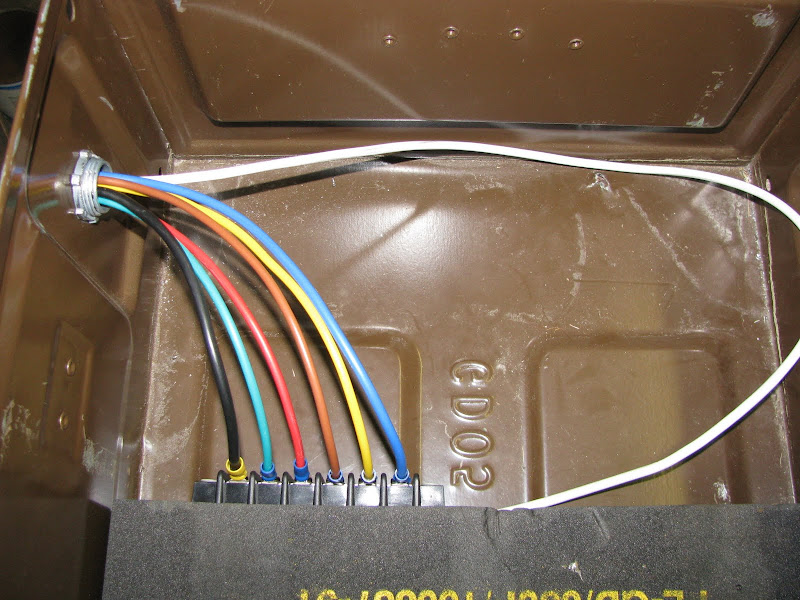

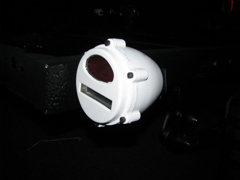

I got a little more done today. I painted the tail lights and put new water tight connectors on the back of them. My 81mm explosive round crate arrived in the mail along with 2 50 cal ammo boxes. I started working on the wiring on the inside of the 81mm box too.
The box has foam partitions which hold 50 and 30 cal ammo cans snugly, leaving room for wiring in the third compartment.
I noticed that the colors of the wires on my 7 wire connector did not quite match up with the standard colors and locations. I have it all sorted out, but I'm glad I checked.
