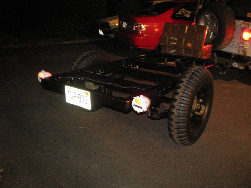

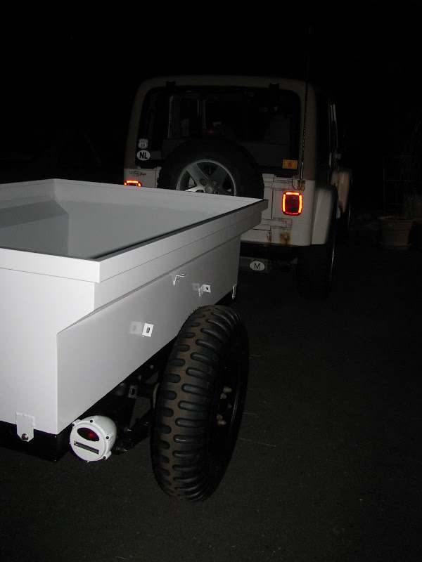

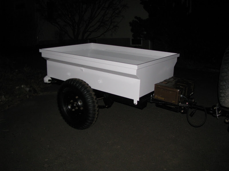

I got the bed on the trailer this evening :victory: and the wiring done last night.
All thats left to do is finish the fenders and renew registration. Oh and some herculiner.
cruisertoy
How much did you pay for the tub to get cut and bent. I'm working with a company in Utah to do one for me. From the pictures it looks like the sides, ends and bottom are all seperate pieces?
sgv209
I paid 650 for the sheet metal on the trailer. 300 for materials and 350 for labor. And yes, the ends, sides, and bottom are separate. The pieces were cut on a water-jet and were absolutely perfect :)

It's bolted down with the tabs on the outside AND with 7 bolts securing the bottom floor to the cross members. This is from post #16. It shows the mounting on the bottom. Its the same mounting set-up that the M416 came with, just a little beefier :)

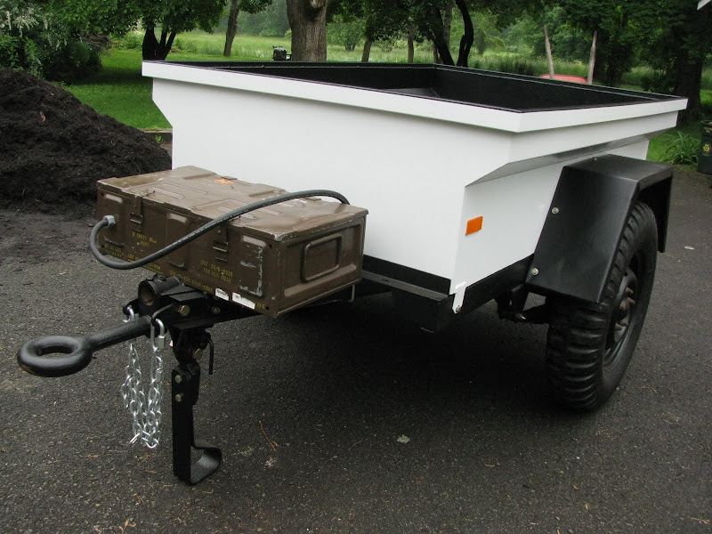

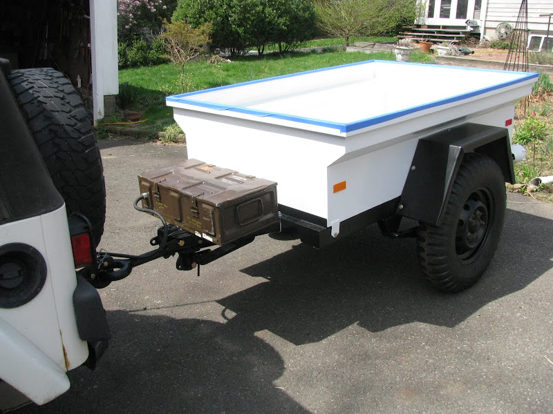

Here is how the trailer stands now, I am waiting on some bedliner samples before I tackle that project.

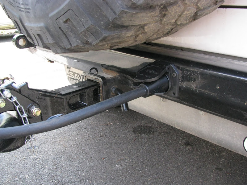

I also reinforced my bumper and added a connector and a place for safety chains.

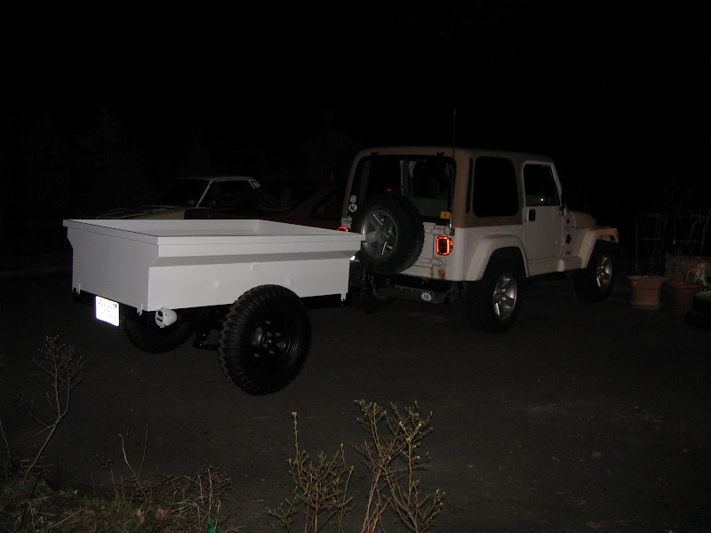

It's been a while since I have made any progress, but the trailer is ready for camping use :)
I just finished putting Monstaliner on the inside of the trailer this weekend, I should be able to start using it in a week or so once the liner fully cures. It is a two part roll on bed-liner that gets its texture from the roller instead of rubber bits inside it. It went on thicker than the herculiner I used on the inside of my jeep, and the sample they sent was nearly indestructible.
