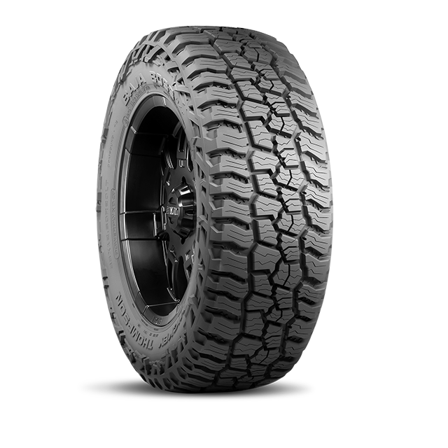

Mickey Thompson Baja Boss AT has a 255/85/17 size which is about a 35x10x17 tire.
This is the size I want to go with. Currently running the 255/85 R 16 Toyo MT. Love it. Would run it again if they made the 255/85R17. This MT BB AT seems like a nice option.
