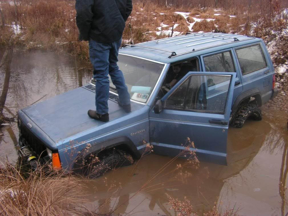

BigAl
Some pics for your enjoyment...
Cherokee with a snorkle
Cherokee without a snorkle
Land of suck
