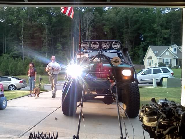

No, no modifications needed for either set of lights, they drop right in and are plug and play. There are no 'buckets' to speak of, they replace the entire sealed beam unit. Just an outer ring that bolts them into the header panel area. Takes literally 4-5 minutes to install, and a phillips screwdriver.
StumpXJ
SE Expedition Society

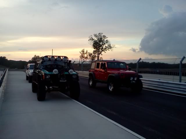

During the swap.

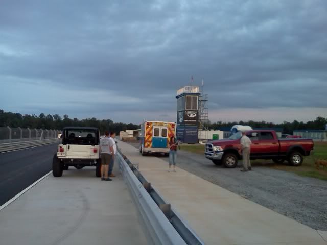

At the race track, getting ready for the lighting tests.
StumpXJ
The results, as posted by Bill. No before shots since we had stock XJ data from my Daily Driver XJ. WE had a lot of lights to test that night, and didnt want to feed the mosquitos anymore than we had to.
