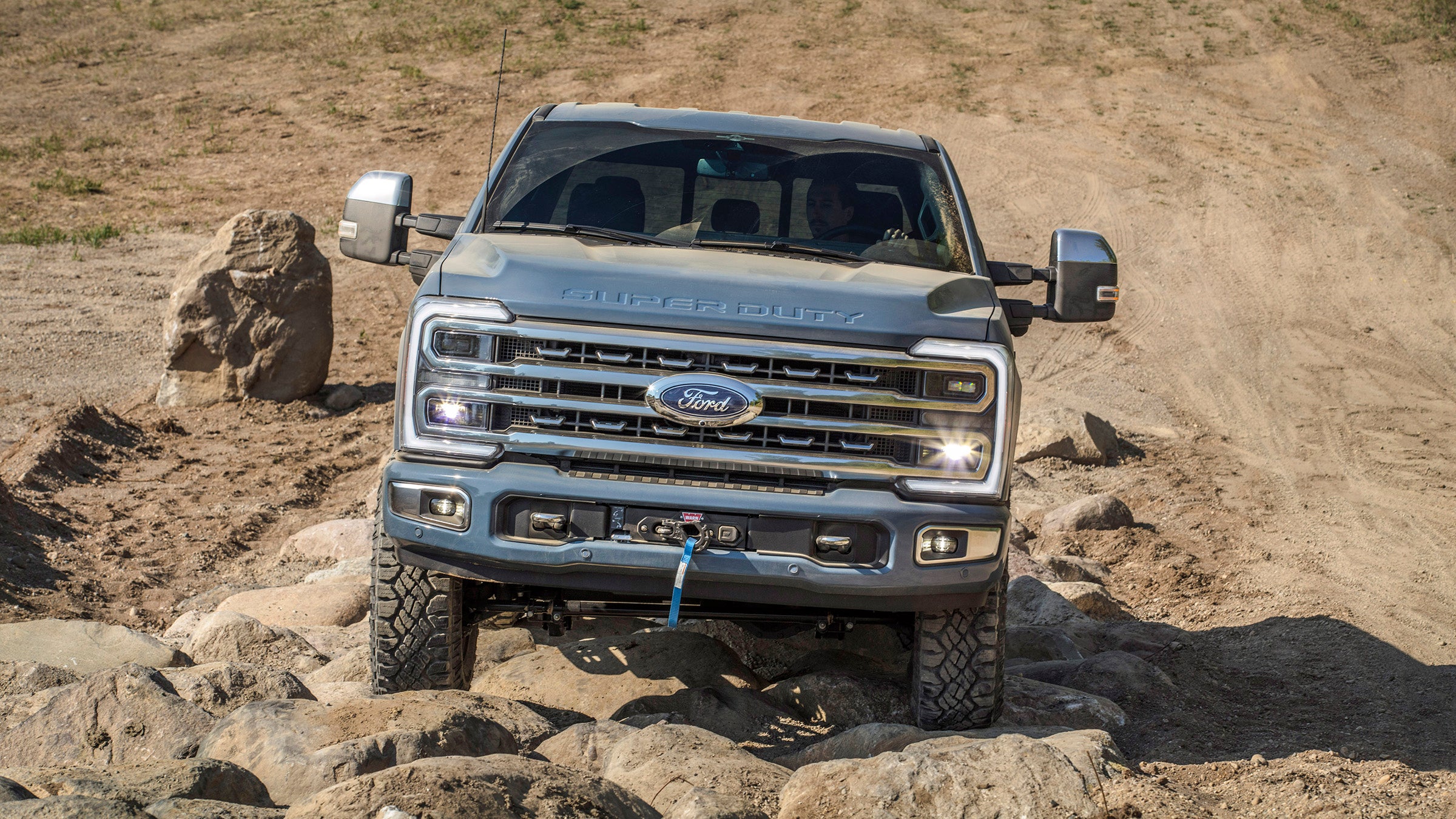

The Tremor is just an example of a 3/4 ton that everyone would deem suitable for that load. If the Tremor takes as long to stop as the Tacoma while both are carrying the same load, then the idea that Tacoma brakes are inadequate when you overload it, doesn't have merit.

You're comparing a truck that weighs 1/2 as much as the other and claiming the brakes on the lighter truck are better. Put the same load in the tacoma and report back.
You mean make them both the same weight? What sense would that make?
The moral of the story is that if an overloaded Tacoma has inadequate braking, then the Tremor does as well.

I never said the brakes on a Tacoma were "great". I stated that you can't claim the brakes on a Tremor are adequate and the Tacoma are not, when both are carrying the same load. Stock braking distance of the Tacoma is only 79% of the Tremor's. Add 3500 lbs to each and the Tacoma still wins (probably).
Making them the same weight makes zero sense... that's definitely an apples to oranges comparison. Isn't stopping distance while carrying the same payload the important point here?
No one is stating that Toyotas are immune to physics. It's a fact however that due to the Tacomas much lighter weight, if you do a semi-intelligent job of upgrading the suspension and tires, it will handle better than a HD pickup... even carrying the same load... and will also brake as well.
Given that, why would would there be a safety concern?

I stated that the criteria was a 70-0 stop. If you believe a different criteria should be used, lets see it. It don't know what you mean by "better brakes".
I stated that the worst case is that the Tacoma is traction limited up to GVWR, and at weights above that, the energy dissipation rate of the brakes is the limiting factor. That's all. Kinetic energy is proportional to mass, so the stopping distance would increase (deceleration would decrease) proportional to the mass at weight over GVWR. It's not going to be worse than that unless the pads melt or something during a single 70-0 stop.
The effect of weight on the tire-road friction coefficient is unknown, but it is less than proportional. It will depend on the tire compounds, the size of the tires, and the pressure as well. For instance in this case the Tremor empty weight is ~1.8x the Tacoma's, but the stopping distance is 1.28x. If you like we can assume that this relationship is a constant? Stopping distance increasing at 35% of the weight increase?
Maybe more numbers will make it clearer. So, stock Tacoma TRD Pro: 4450 lbs, 70-0 in 180 ft. GVWR is 5600 lbs. 20% overload is 6720 lbs, or 2270 lbs over stock.
Up to 5600 lbs the Tacoma is traction limited. 35% of the weight ratio (4450 to 5600) gives a new stopping distance of 196.3 ft Above that assume it's brake limited. 100% of the weight ratio from 5600 to 6720 lbs gives us 235.6 ft.
The Tremor diesel weighs 8050 lbs, and takes 229 ft to stop from 70-0. Add the same weight of 2270 lbs as we added to the Tacoma, and it's up to 10,320 lbs. The Tremor will remain traction limited rather than brake limited with this load. 35% of the weight ratio gives us a new stopping distance of 251.6 ft.
It's not an opinion, it's a statement of assumptions... and then physics.
