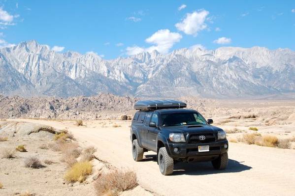

I would prefer a topper with win-doors on both sides and a low profile rack on top. Then I would buy a low profile rtt like the James Baroud's or Autohome's. Much like this gentlemen's setup ( Yedi ). That way you still have the functionality of the topper whenever you take the rtt off.

Sweet rigs guys!! Thanks for the input. Tacomajack09 do you have any idea how much comfort and versatility you loose with one of those low profile rtt's?

Depends on your level of comfort I guess, it still has a memory foam mattress and you can get ones with enough room for 3. You loose a little head room, and space compared to the fold out tents.The ease of setup and tear down makes it worth the slight loss of space imo. Especially if you're constantly on the move like on a road trip where you're not staying multiple nights at one spot. I've seen versions of these hardshell tents where you can unzip the tent walls out, remove the mattress and you're left with storage space much like a yakima rocket box. So I think the versatility is still there as well. I'd suggest googling Autohome's and James Baroud tents for reviews and stories.
