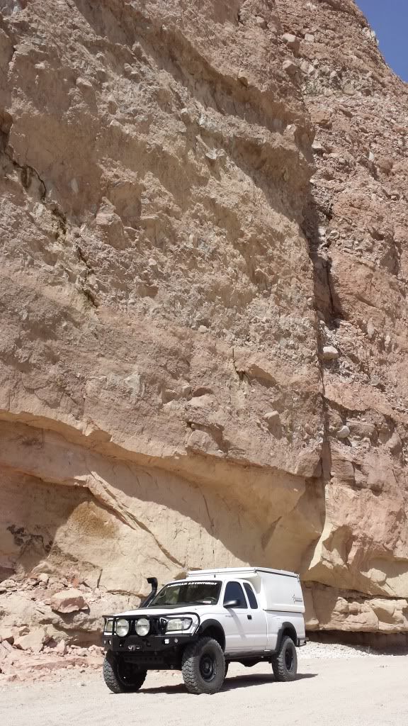

Have you noticed any change in stability since changing to the pizza cutters?
I did. The wide 285's did indeed provide a more stable ride on the pavement. It feels slightly more susceptible to being pushed around in crosswinds. Potholes tend to feel less stable as well, although I would guess this is mostly due to the stiffer E-rating rather than any true loss of stability. Off pavement, no difference. There wasn't any perceived loss of stability during any side loading. I've been happy with my decision to switch and have zero interest in changing sizes again. The 255 sizing feels like the right fit on this truck.

And while I'm at it... another picture.
