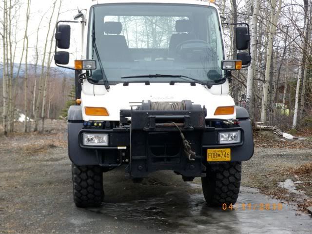

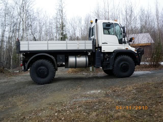

Here are photos of the U500 provided by Dan Johnson
(The height of the conventional trailer hitch gives you a sense of how large the U500 is!)

This model is the long week base model 3900 (153") and has the high speed option. It can go 70 mph. That being said at 65 mph the road noise gets pretty loud with the XZL tires. On a 4000 mile trip I found that 55-60 mph was very comfortable. It has cruise control so you set it and sit back and enjoy the view out the picture window. You can carry on a normal conversation. The more you are carrying the better the ride.
I stated the truck was a 2004 but I was mistaken it is a 2005.

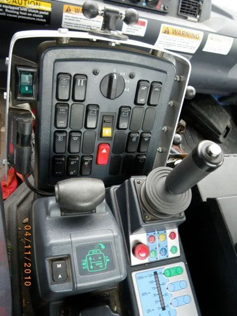

I keep getting asked about the options so here is a list of the one on the 2005 U500. I was unable to determine what all the option codes were. Maybe someone who knows more can help fill in the blanks. These codes were taken off the Mercedes build card.
Thanks
Dan
U500 Options
A30 CTIS
A31 Other parts for CTIS
A52 Differential lock in from axle Crawler gears in the transmission. This truck has crawler gears and super low crawler gears for a total of 24 gear forward and probably that many in reverse.
B42 Air glads for air trailer brakes.
C47 Radiator Protection
C50 This option lets you move the steering wheel, petals and instrument cluster from the left to the right side of the vehice. Would be great for an expedition vehicle that is planning on going to New Zealand and Australia or other place where they drive on the right.
C88 Vertical exhaust.
D12 Front mounting plate. I have a 25,000 lb winch attached to the plate. The winch can be removed by removing two bolts and lifting it off.
D50 Rear attachment brackets
E44 Jump start studs. There are below the battery box. I you need to get jumped or to jump someone else you just pull of the plastic caps and hook up you cables to these studs.
E45 Front mounted 7 pin electrical plug
E47
E53 Prep for CB/mobile Tel 12 volt including antenna
E54 This is a prep for 2 way radios 12 volts including antenna
E55 Antenna and two loudspeakers
F43 Additional Heater with Engine pre heating. This is a Wabasto diesel heater that had a timer. You can set the timer to heat cab and engine any time you want. I have used this in Alaska to pre-heat the engine and cab.
G21 Working and crawler gears
G48 This is the auto shifting option. You can chose manual shifting and a clutch petal folds out or Auto where the clutch folds in and the shifting is automatic. The good thing is that transmission is a geared transmission that is shifted via the computer in the auto mode. I works really nice and I rarely use the manual mode.
H08 This is the hydraulic option. There are two hydraulic circuits in the front and four in the rear. There is also some on the side and one for the dump cylinder.
H14
H57
H58
H59
H61
H68
H75
H76
H78
H79
H85 All of the above have to do with hydraulics. I think it has more hydraulic than most people need.
J48 Warning light for tip cylinder. This tells you any time you bed is not all the way down.
L07 Daytime running lights
L47 Raised headlights
L58 Support for rotating beacon. There also is a beacon
M54 Block heater
M55 Fuel and water separator with heater.
M89 Grid heater on intake.
N08 Front PTO
N18 Retrofitting possibilities for PTO
P01 Quick release for tipping cylinder. This is lever that when pulled will detach the tipping cylinder from the bed.
P40 Tipper body
Q20 Pintle hook
R34 Rims for CTIS
S02 Air ride drivers seat and timed engine pre-heater
S10 Air ride passenger seat
S26 Heated windshield
S39 Power windows
S82 Wide angle rear mirror
S83 Downview mirror
S86 Right hand mount wide angle mirror
U82
V97
X18 Upgrate to 33,000lb GVW
Y31 Tire inflation Hose
Y76 Front license plate holder
Z43 Cold weather package for starting
Z68
Z99
9678
