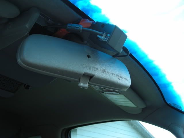

I've also installed a Green Light Labs GPS 710 module for my radio. The GPS puck mounts out of sight behind the rear view mirror and the cables pass into the front of the overhead console.
It's very easy to install, essentially plug and play. There are a couple of settings to change on the radio but the instructions detail how and what you need to do. It's nice having a redundant GPS that's a part of the radio. What I did not realize is that the GPS module is not compatible with Overland Navigator. I don't run O.N. at this time, but I may have gone a different route had I looked into it a little more and realized that the two won't work together.

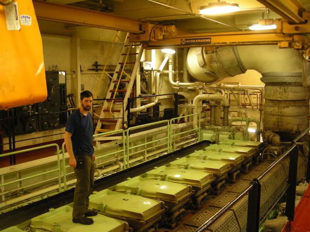

Naah, I just try to enjoy the heck out of my time on dry land. Half of my year is spent making up for lost time from the other half of the year I'm busy walking around on ship engines:
That little fella is only about 15,500 horsepower and is one of four on the ship I currently work on.
