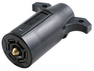

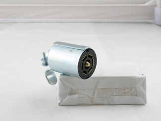

So, they have a metal one:
and a plastic one:
I suppose I will try the metal one.
