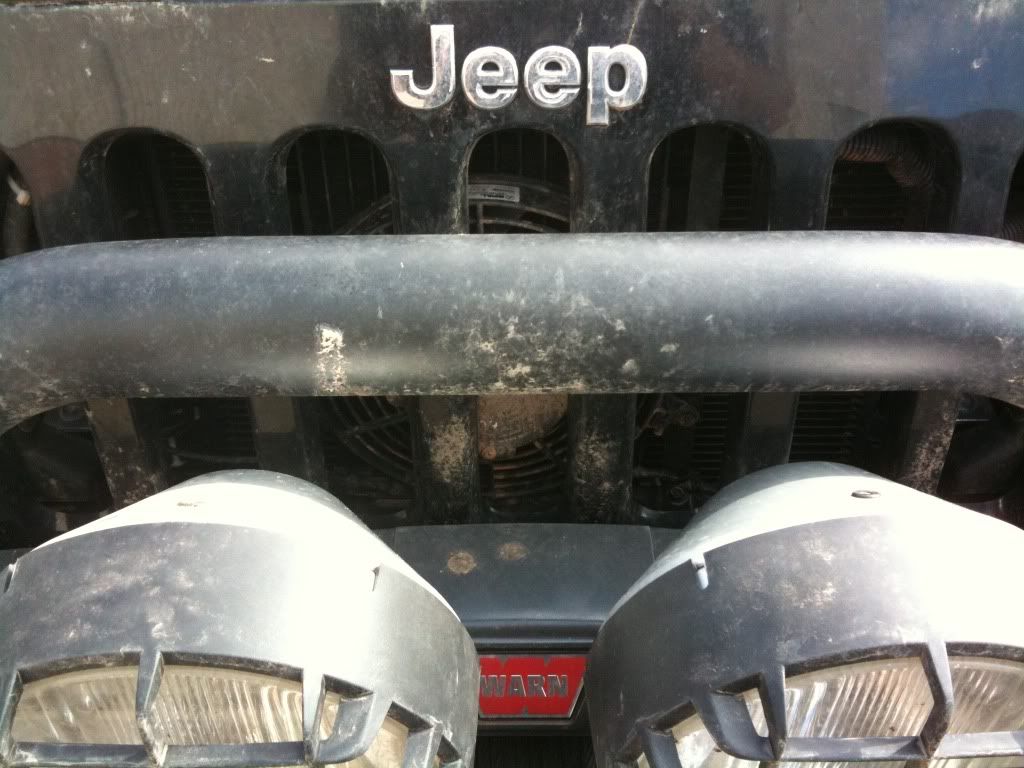

Funny thing. This was my first trip of any consequence with the completed rig pulling the trailer. I found out that pulling the trailer up any substantial grade (long ones) it did run hot. FYI: the computer shuts down the AC when it gets up in the upper 240's. Anywho, I saw and spoke with Dan from Burnsville (provider of my self installed Hemi kit) about the temps. Right off the bat he volunteered his new and improved (40% better) radiator to replace the one that cane from the kit. No, it's not normal to get that hot. The 6.1 normally runs between 200-220. I believe it comes and is designed for a 210 thermostat.
Aside from getting a bigger/different design radiator, I have a few things that cancontribute to those higher high speed temps. Don't forget I was pulling 2200 lbs at over 9000 feet and rapidly climbing in elevation (and driving hard).
1) big light out front DOES affect the forced air flow getting naturally through the cooling system. The BOR kit is different than the AEV in the fact that the computer funs the fan based on temps versus the "all the time on" fan setup with AEV. I dont know of the computer's handeling of the fan at speeds.
2). I installed the biggest thermostaticly controlled cooler and fan setup I could find. It's automatically activated at a trans temp of 175 and the trans cooling is completely seperate to normal cooling. Meaning the stock trans cooler is part of the radiator. The Hemi conversion I run uses that stock trans cooling for just the power steering now with a independent trans cooler (hense the big one I put on in preperarion of normal higher engine temps and towing my Chaser)
forgive the pic but if you see all that stuff it can significantly block forced air flow at higher speeds:
I was concerned about cooling while offroading. No problems there. Temps stay right about 210-220 all the time idling, crawling, no matter.
When I did experience the 250 degree temps (scan guage reading and upper limit traditional temp gauge) just slowing down or stopping immediately remedied the situation. Fan alone cooling works perfectly.
