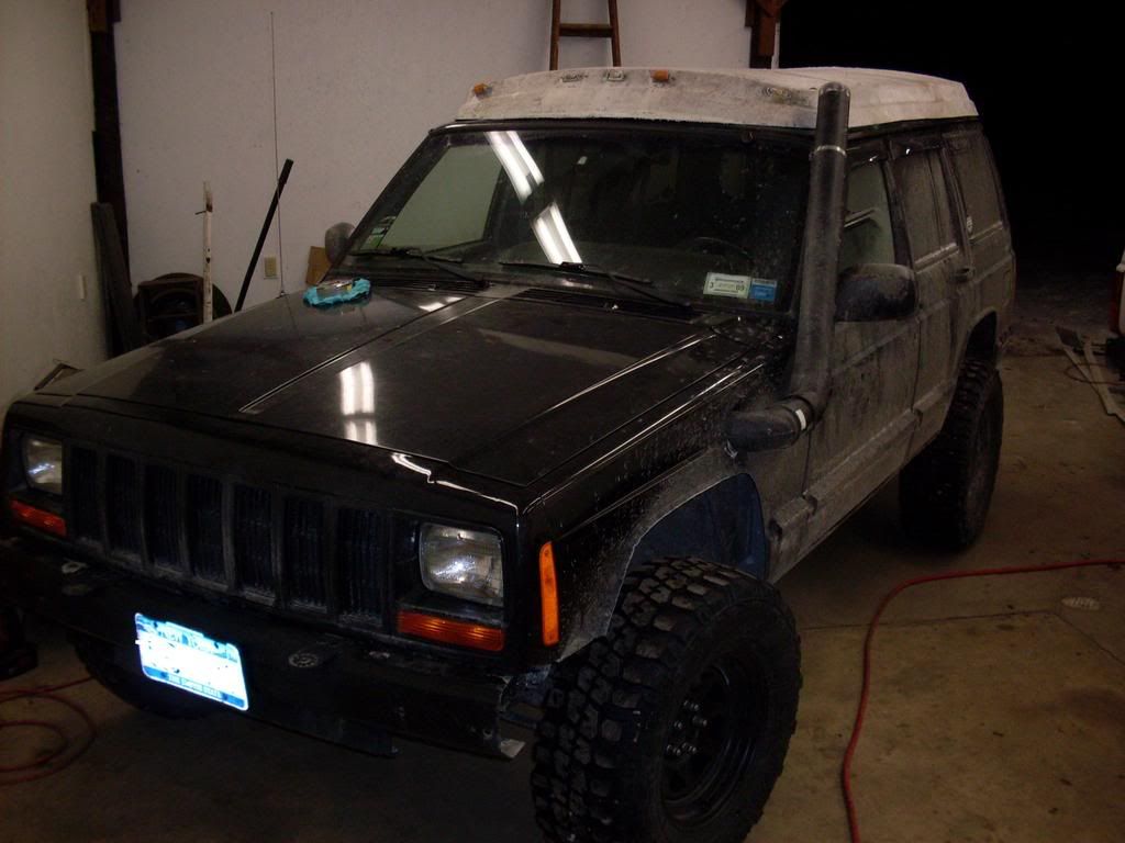

OverlandXJ said:
This may help. It's a prototype that never went into production from what i'v read. You can see it's been reinforced inside with framework connected to an interior cage.
http://i172.photobucket.com/albums/w37/grimmpics/IMG_6513.jpg
LOL, that is/was my buddy Tony's XJ. I was there for "install" of the hole. It ended up being an article in JP Magazine.
He already had a cage, already had frame stiffeners (TnT), and the cutting of the roof didn't do crap to the door alignement,closing, or measurements between pillars... regardless of the fact that the cage didn't tie into the pillars.
All that said, I have no fears cutting a hole in an XJ.... but I do agree with the "live around" sentiment. Basically to me, either you sleep in it, OR you do everything else in it... (cook, clean, bathe, etc...). I can't see the space for both. And even with 2 or 3 feet extra clearance with my XJ, I'd still be cooking on my knees.
