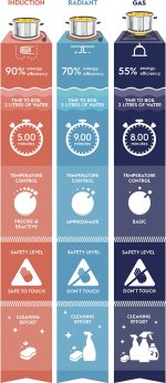

This is good progress for sure. When samsung introduced their 30TB flash drive ~8 years ago, it was the same price as a Honda Accord. So yeah, time (and market volume) will definitely solve some of the cost issues. Having said that, when the volume increases this will be like NiCaD to LiFePO4 improvements. Can you imagine an induction cooktop in a rig in 2010? Now it's a good idea...
crazysccrmd
Might be premature to declare induction cooktops a "good idea " when most kitchen stoves on the residential market still aren't. Same in RV's, propane is still dominant and for a simple reason, cost per btu/watt.

Exciting development in solid state batteries for sure!
Induction requires a ferrous metal pot or plate to heat, and its overall efficiency is dependent on using power that is always converted from a souce into electricity, rather than direct like town gas, propane, or white gas. Adding a level of complication to a device always has a downside, converting power to electricity involves another step in inefficiency. Much like the twice daily coal train that passes my metro to generate electricity in Mobile AL. The EVs there run on coal from Wyoming and the trains have been running for decades, long before Tesla's first unit came off the line. That is a diesel powered train.
Cost pet watt/btu is what it all comes down to.
I doubt that many overland rigs and sailboats are being built with anything but induction cooktops these days, the upside to them far outweighs the cost and complexity given that finding propane can be a right pain in the butt in certain parts of the world, is an explosive and fills the room with toxins. A standard "off the lot" travel trailer might come standard with gas but those are far more about economy than world travel.
When talking about efficiency you need to add in the loss of energy when cooking with a flame vs magnets, a lot of energy just goes around the cookware and heats the room not your food.

I can't imagine going back to propane. To boil water on our induction cooktop, it takes about 5 minutes pulling 1750W. That is 145Wh of electricity. I can get that back in solar with about 10 minutes of solar power. When I build my next rig, I plan to go all electric with only a backup diesel heater. The hot water will come from an 8000W instant on hot water heater. A shower would use a max of about 400Wh. This is far more efficient than a propane or diesel water tank that is running all the time.
