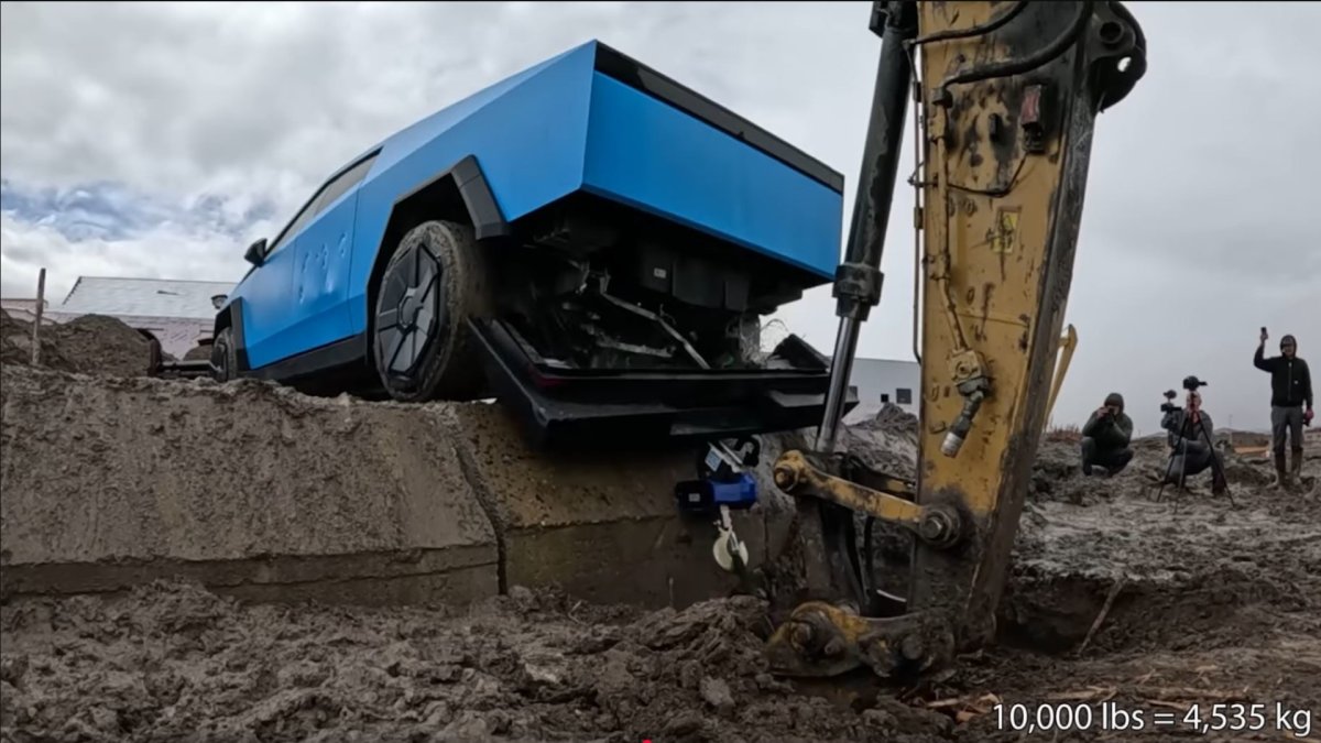

According to these two interesting and enlightening stories, the decision to use cast aluminum for the frame on your vehicle that supports your towing infrastructure might not be the best idea.
cricketwagon
Do you fly places for business or pleasure ? Aren't you concerned that the air frame is made out of aluminum and is exposed to significant stresses like turbulence ?
In all seriousness, what's the maximum dynamic load that a properly setup 11k trailer is going to put on the hitch receiver ?

In all seriousness, there are adhesives used even in the aerospace industry. When the correct compounds are used in the right context they can perform just as good as the mechanical fasteners while reducing complexity and weight.
cranecamsou
Just a guess here, don't shoot me....
11k lbs trailer, should be ~20% tongue weight. Let's say there should be some built in allowances for owners getting this wrong, so let's say 30% is within reason.
11,000 * 30% = 3,300 lbs static load
I would estimate dynamic loads on the highway, potholes, dips, speedbumps, etc could be 3x the static load pretty frequently.
3,300 static * 3 = 9,900 lbs dynamic. So yeah, the subframe breaking off at 10k Lbs seems like a major issue

I might be just an unfrozen caveman lawyer, but are airframes forged aluminum vs this cast aluminum?

I thought tongue weight was supposed to be 10%? 15 maybe?

Yes, your numbers are significantly off compared to the actual the physics expected. This was posted on the CT forum with the citations to the specific standards and testing methodologies:
Screenshot 2025-03-21 at 17-54-38 Cybertruck Trailer Hitch_Casting Failure @10 400 lbs VERTICA...png
cricketwagon
Airframe components will typically be extrusions and billets (machined parts), castings can potentially be in the engines. I'm not aware of the forged aluminum parts on the airplanes, but just so you have the context - forging is a type of a post-processing method on cast aluminum, famously used for the AR-pattern receivers. To make things more murky, aluminum casting is not a single process. Tesla uses high pressure injection with a vacuum to ensure consistent and high quality castings. For comparison gravity casting without evacuating the air will result in gas trapping and generally wouldn't be suitable for structural parts. So then the final caveat revolves around the aluminum alloys in general, their grainy structure regardless of how the parts are made, and resulting lack of the Fatigue Limit, but that's where we go back to the use of aluminum in more critical applications such as airplanes with a consistently good track record.
