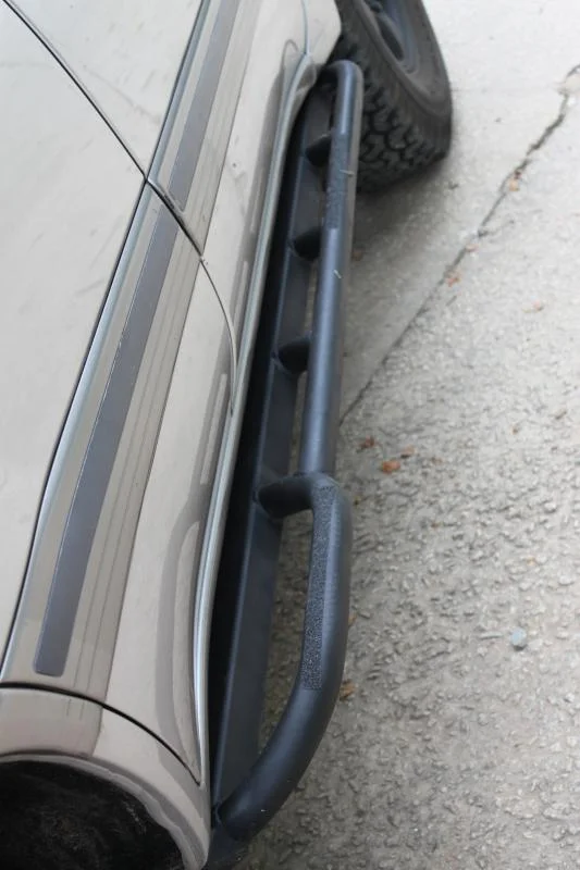

added some White Knuckle Sliders, tested them out at Amicalola last weekend and they are nice. Next modification is most likely some skid plates as mine have been destroyed pretty much. And rear bumper since my current on is being held on by 2 bolts. Sliders have 3 feet and are extremely well made. They were a touch over 6 bananas shipped. Which is 4 bannanas less than Slee's sliders (not knocking Slee, he makes great stuff). Which was a no brainer

and just for fun :sombrero:
pre-sliders...
