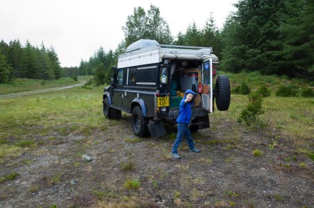

My 110 is 36 years old this year. It was s/h and 5 years old when I got it, and was well maintained by a utility company. The first engine was 2.5TD which was ok but got tired at 125,000 so was replaced with a 200Tdi of unknown age but which has now done an additional 200,000 miles with me but had probably 50k miles on it at least when it was fitted so its been excellent. Oil changes every 4k miles helps as does all the other fluids being changed regularly.
This may be an odd take on this, but whilst the comments above about the issues caused by steel/aluminium construction are real, that same construction allows easy repair by even the most cackhanded of mechanics! Where I live with winter salted roads and lots of rain, back doors last 10 years, easily replaced. Front doors 10-15 years before needing some TLC with repair parts and replaced at 25 years if you're lucky. The 'boxy' construction allows for flat sheet repairs whether pop-riveted on (for alloy) or spot welded (for steel). The lack of curves in many of the vulnerable places makes for easy fixing and, in my case, adaptation.

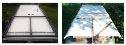

Over the years I've changed lots of parts, and added bits that seemed practical. The biggest is the lifting roof, made on the drive with minimal tools, and sporting a fabric sided roof tent. This was ok but cold in winter and noisy on windy nights. So after some consideration I added insulated hard sides and electric lifting. This is more comfortable. Because of the flat sides and proper corners (rather than lots of curves as on some other contenders) it was relatively easy to make things without access to specialist tools, and aluminium is light and easy to toss on and off by hand in the process.
So this is a 36 years ol 110, lifting roof, water tanks in the wings, extra fuel in rear wing, interior sink, fridge, sleeping for three adults and a child at a pinch (child is small bed across front seats, two adults 'upstairs' and one below) and bowls alone nicely at 55mph all day, with enough power from the old engine to get near to 70mph if you want to.
