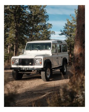

Just picked up one of my dream rigs! Will use this space as my build and travel logs. We have grand plans for this!
1998 Defender 110 5 door
300tdi (Luckily re-built 30,000 km ago!)
R380 5 speed
Galvanized frame & factory A/C!! Got lucky with this one!!
Fresh off the boat from South Africa, we are headed out of the country for some warmer weather, so unfortunately won't have any fun progress to share until end of next month. Have some basic maintenance to get done first, probably some new wheels and tires too. But then I will enjoy it as is for a month or so before I start throwing fun things at it.

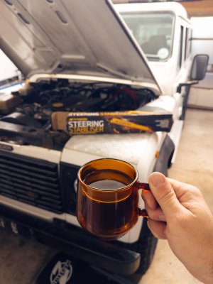

Included in this round of maintenance is the steering damper. However, it seems I have two, one on both arms. I can not find anything on the internet about this and wondering about just taking the one on the track rod. Every single video I have seen is just the normal drag link one. I ordered the OME one to replace it. With the 33s should I just leave the rear on as well? I did order 2 of the OME dampers just in case.
Front, business as usual:
The track bar one?

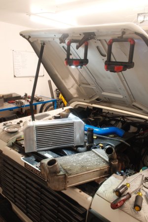

Wow I have been horrible about updating this. I have done a ton of work over these past weeks. Changed all the fluids and filters. replaced the water pump, p-gasket and thermostat, new tie rod ends and swivel hub seals, axle seals, brakes all around, new steering drop arm, new intercooler and hoses, valve adjustment, EGT gauge, boost gauge, sound deadening, safari snorkel, new radio, new wheels and tires then got the diesel heater installed and made a custom cubby for it.

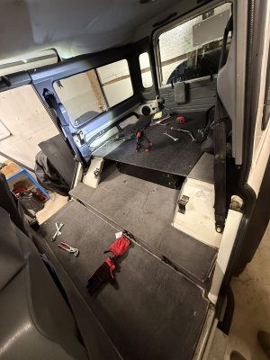

Also pulled the rear jump seats and 2nd row to build out the rear for camping. Still in the planning stages for that though, first real trip is planned for memorial day weekend but am hoping to get out at least 1 or 2 weekends sooner than that but we'll see how the weather turns.

OME Steering damper

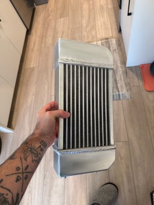

Ebay intercooler, factory one was leaking, swapped out for some nice Terrafirma hoses too

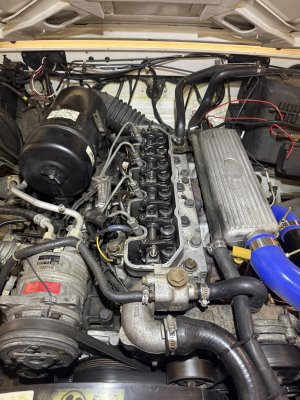

Valves were chittering and I was getting a bit of white smoke, and since I had no idea when the valve adjustment was done last I figured I'd go ahead and do it. LR recommends every 6000 miles which seems ridiculous. Guess I will just plan on checking them every oil change.

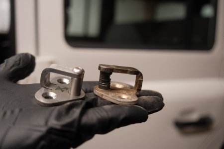

Replaced all the door latches as they were absolute toast. Doors shut nice and tight now!
Seat removal, planning planning......

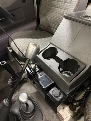

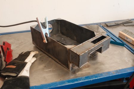

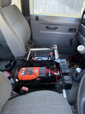

As anyone with a Defender knows, the heat it pitiful. Built a version 1 of the diesel heater cubby to house the Vevor 2kw and lots of 12v outlets, had to finish it in a day so we could go on a trip so its a bit rougher than I'd like. Planning on a V2 later this year.
