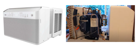

Midea makes an 8,000 BTU window AC with inverter technology for $400 that is almost a mini-split, but not quite. It is a U-shaped unit that has separate motors for the condenser and evaporator fans, so the only things connecting the front and back half of the units are electric wires and the refrigerant lines. This could in theory be divorced into inside and outside units for a fraction of the cost of a larger mini-split. This video has a good look at the internals:
