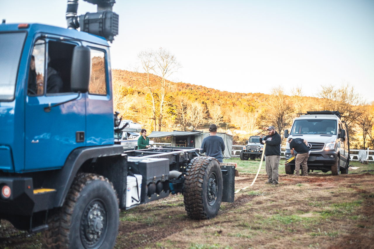

We wandered into Brevard, NC for EAST and enjoyed a really good week at REEB Ranch. The event was very wet which created a really challenging week, but it was a fun first Expo EAST experience. We now want to return with bikes to enjoy REEB Ranch and DuPont State Forest properly.
The weather was crazy and the truck handled the mud, rain, and more mud with ease. We were hoping that this shakedown trip would give us a chance to shakedown the truck and find any issues that could possibly come up on our trip to Baja. The list is growing…
