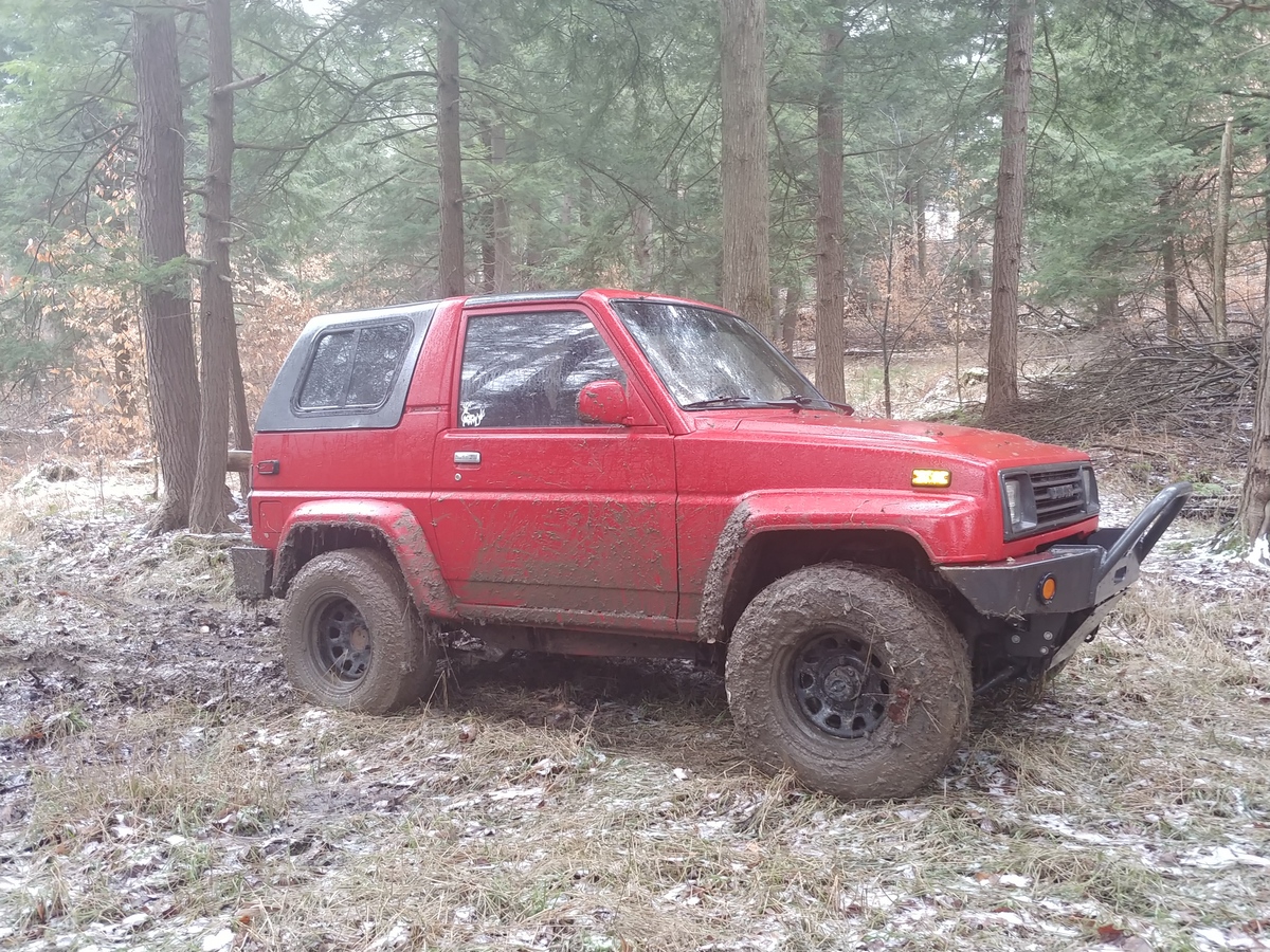

So, I found a "secret" way into a place I've been trying to get into for a long time. Despite the shutdown, I do not wish to fall afoul of the Forest Service, so instead of trespassing, I found a way in along an old path that could get me where I wanted to go.
A little muddy, yeah?
Well, then we went and did this, didn't we?
Then, as we gathered the troops to get out, an inch of rain fell, and the trail became the stream.
All was finally well, and I did get out. But I learned some things in the process that need to be addressed.
