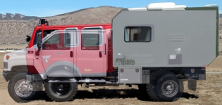

If yer gonna buy one of these beasts, THAT one looks really nice. Ticks a lot of the truck and camper boxes. And, it has UNICAT in the mix. Looks like they built and mounted the box, another plus.
But to the OP, note the replacement springs, fore and aft.
This beauty was build when I was employed by Unicat. Hands down my all time faiv. Expo Truck. Everything seamed perfect on that one.
