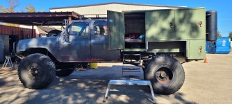

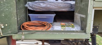

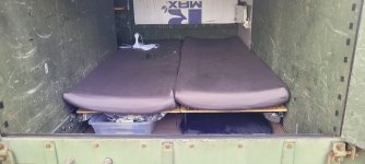

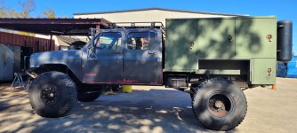

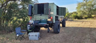

So it has been a while since I updated but for the most part I have been driving the truck and working out little bugs. I ended up installing bigger lift rear springs to get rid of the sag in the rear that I had, while I was at it I replaced the rear main eye hanger. Over the last six months I have started to try to rough out the camping area in the back, a couple weeks ago my youngest son and I took the truck out for the weekend and did a little shake down. Everything work well, I found so things I want to move around but my son had a blast and that’s what its about!20231112_141453.jpg

I love this truck so much. It’s way too big, it’s powered by my fav tractor motor, runs mrap wheels, custom 4link up front and that mil box on the back. It’s everything a 4 door square body deserves to be. Super nice work man. Very cool.
Thanks! Its a lot of fun, I am really looking forward to getting the box sorted out for camping and getting some trips in!

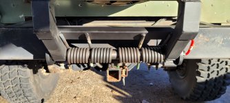

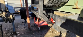

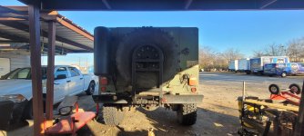

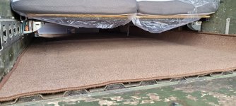

Been a crazy year, I had a turbo go bad and had the input shaft and counter shaft blew up in the transmission. I have come up with most of a plan for how I want to layout the box and that project will start soon. I have just finished my current attempt at a heavy duty spare tire carrier, It is made up of using trailer springs to help raise the tire back up. I also finally installed a set of RV steps that I narrowed for getting in and out of the box.
How much assistance do the springs provide? Any idea what the wheel weights and how much force do you have to apply to raise it? Looks like a great idea and definitely beats adding a winch.
