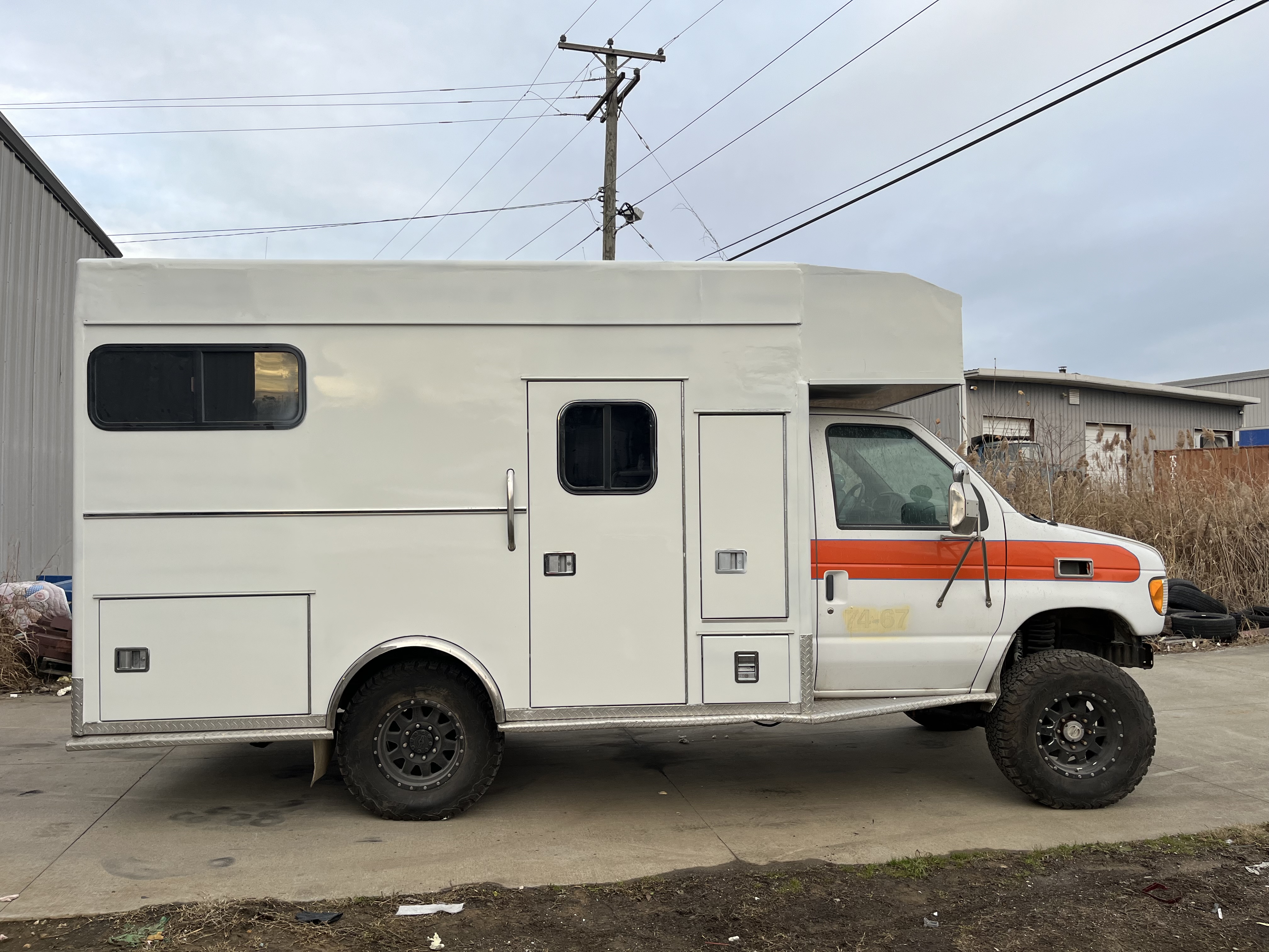

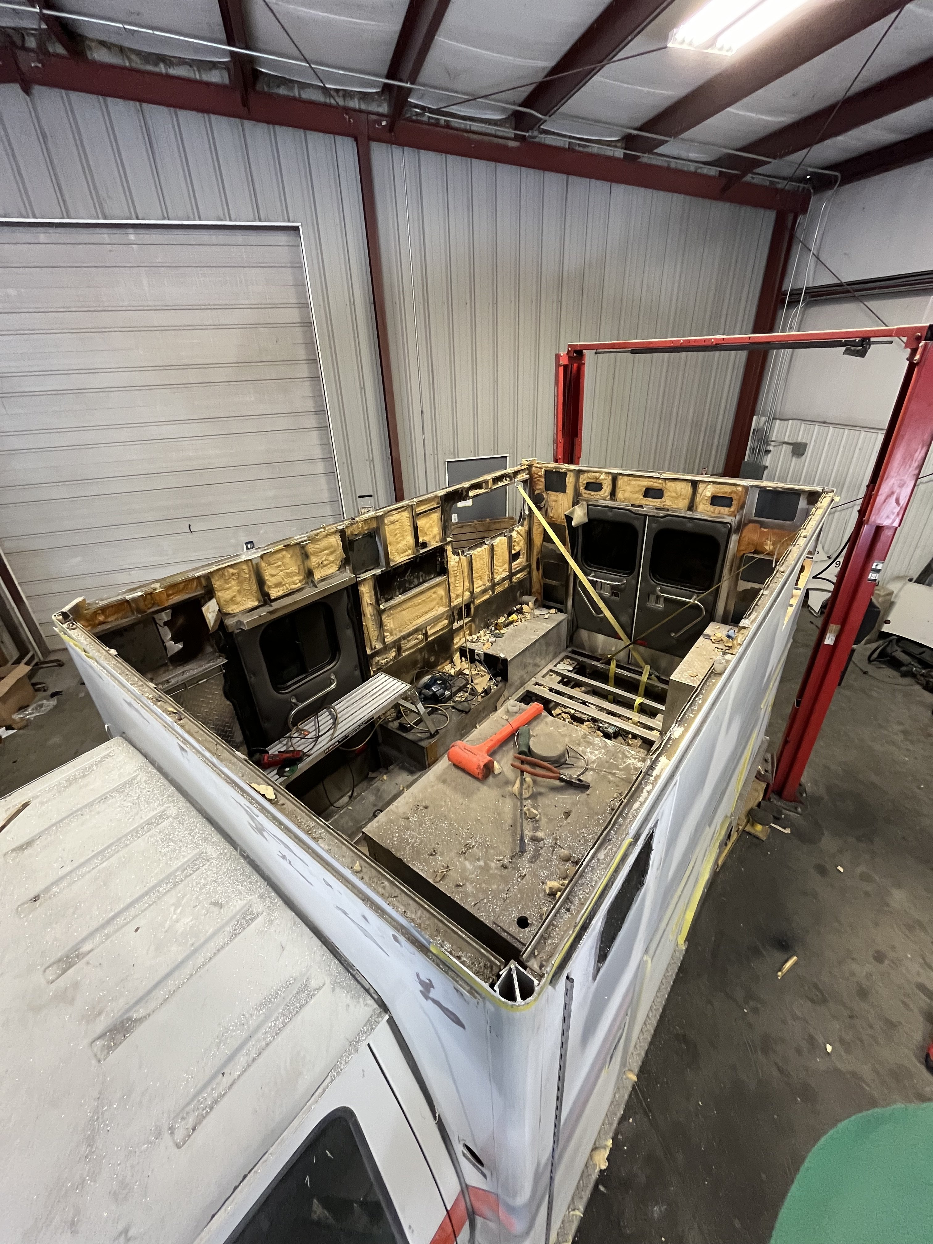

The top has been cut and raised 10” as well as a custom fabricated cab over for extra storage or another sleeping area. Interior height is now roughly 6’6. The interior is completely stripped and ready for someone to make it their own.
The ambulance box just got sprayed the original Ford E-Series white to match the cab. The body shop didn’t do a good job of blending the corners of the roof raise so the body work is certainly sub-par. I have an extra set of front seats with swivels, an 08+ front end conversion kit and some other miscellaneous parts that can come with the ambulance if you want.

(The van is parked on a reasonable steep driveway in the photo’s that’s why it looks squatted)

Also do you have photos of the inside condition other that the view above with the top removed?
What's the current curb weight and total GVWR? Do you mean it's parked on an angle and the ambulance body is squatting to maintain level inside? Some underside shots of the running gear, suspension, and the conversion would be appreciated.

Cool rig. In the photos there appears to be quite a distance between the outside of the rear wheel and the ambulance box/fender. Did you put a different box on the chassis?
Looks super sketchy for rollovers with the narrow track rear end and tall/wide body.
It was a factory SRW unit! I’ll get interior pictures tomorrow!
Can you share the VIN number to confirm this? AFAIK, the wide body ambulances were never built on SRWs. The E350 cutaway chassis with a 11K GVWR needs that dually in the rear to be able to carry that weight. Did you buy this as a SRW?
