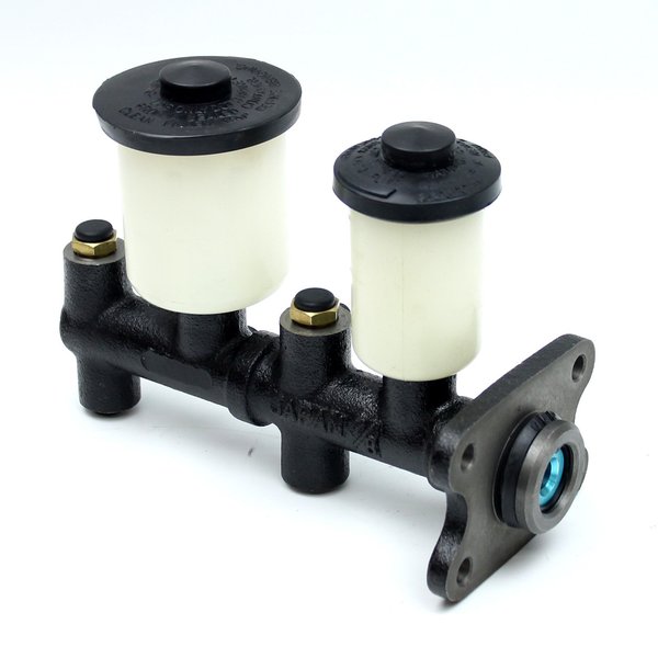

If not you can swap the master cylinder and the calipers,you need 4wd rotors.
If you dont use the tundra you want to look for a tacoma, or 3rd gen 4runner master as well as pads and rotors. Good sold upgrade.
good to know, i'll keep that in mind!
