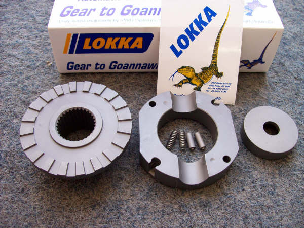

And placed order for Lokka front locker! $259 shipped! I couldn't pass up the great group deal at Club-Xterra forum. :)
I'm not quite sure when I will get around to installing it. I may go all crazy and install it before I get the rear locker.
Lokka is just time consuming for the most part. Glad you got the new U-bolts. Didn't want those breaking on you. Most route the rear diff line up to the DS brake light for the just in case deeper water.
