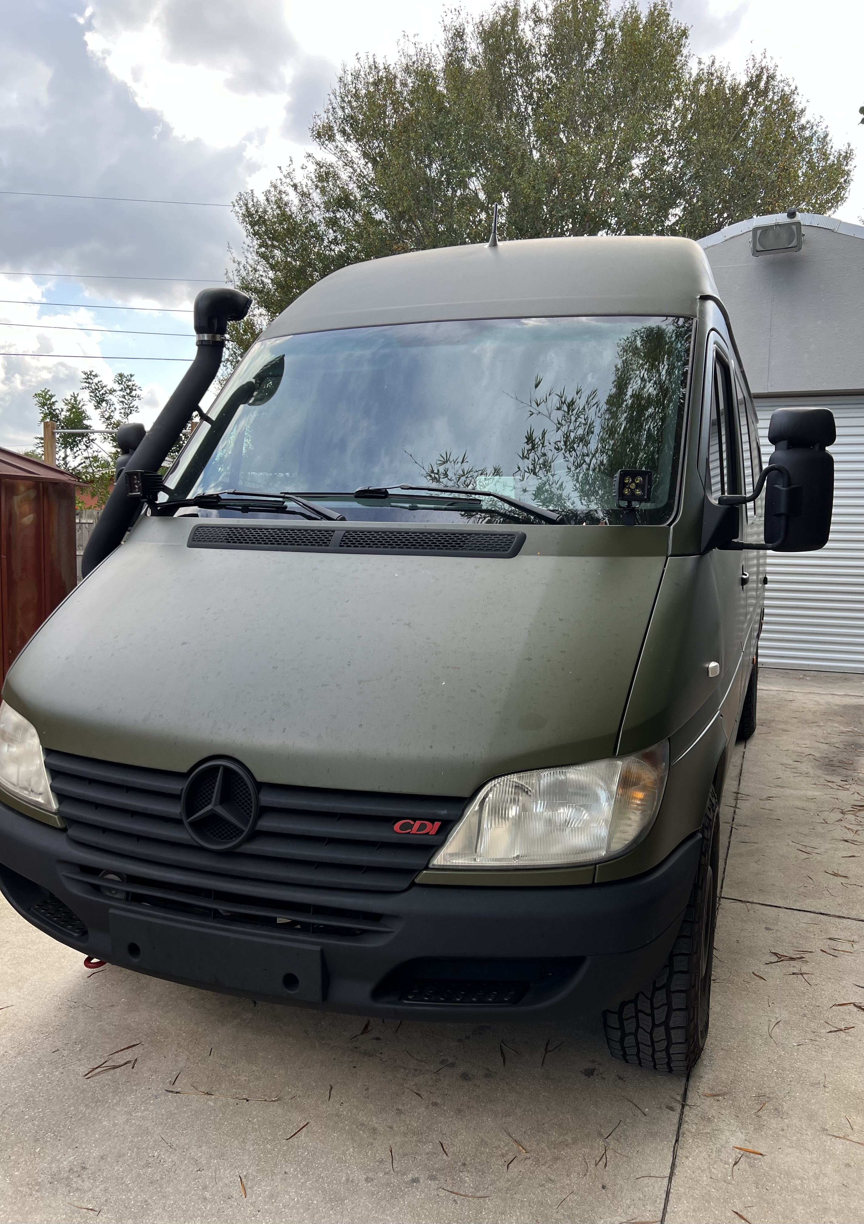

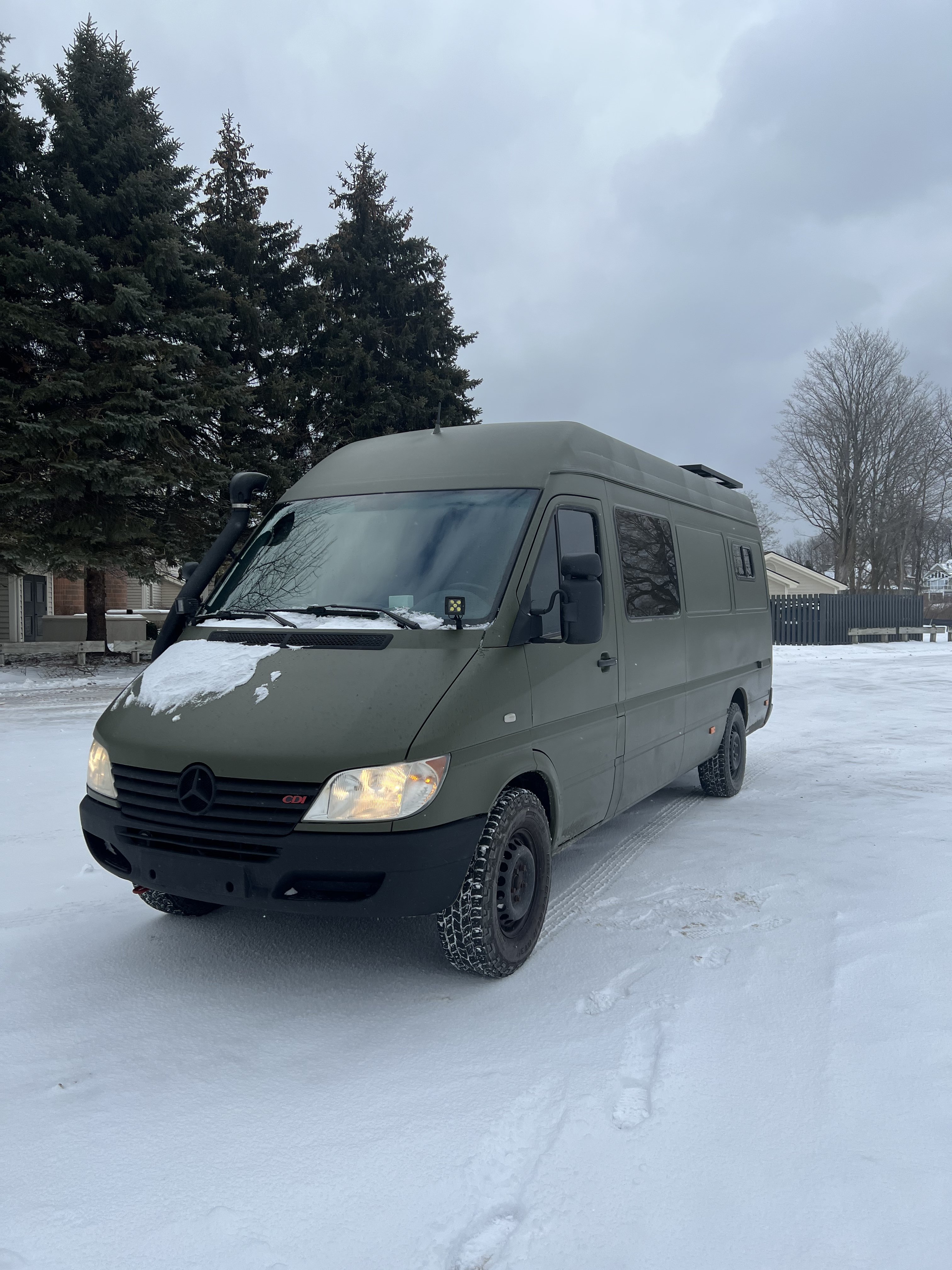

2004 Mercedes T1N Inline 5 diesel, 320K miles, 2wd, Located In Central Florida, $55k or best offer.
To start this sprinter was owned it's entire life by Baker Mercedes in South Carolina as a parts runner, It was bought by one of the Mechanics when they retired it, I have screen shots of the CarFax showing the history of services since new. It does have high mileage depending on who you ask, some people think the best T1Ns are higher mileage since more stuff has been replaced and everything on this van has been replaced with OEM from the dealer. Everything I have replaced has been bought from europarts-sd/MMS/IDPARTs/or the dealer.
I have done everything to this van, I am a woodworker/home remodeler so a lot of the building was normal working other than not being square and tight fitting. I spent a lot of time thinking of the design on this van. It's a serious challenge to incorporate usefulness, ease of maintenance, and comfortability and to make it look really nice! But I feel like I did a pretty good job on this van.

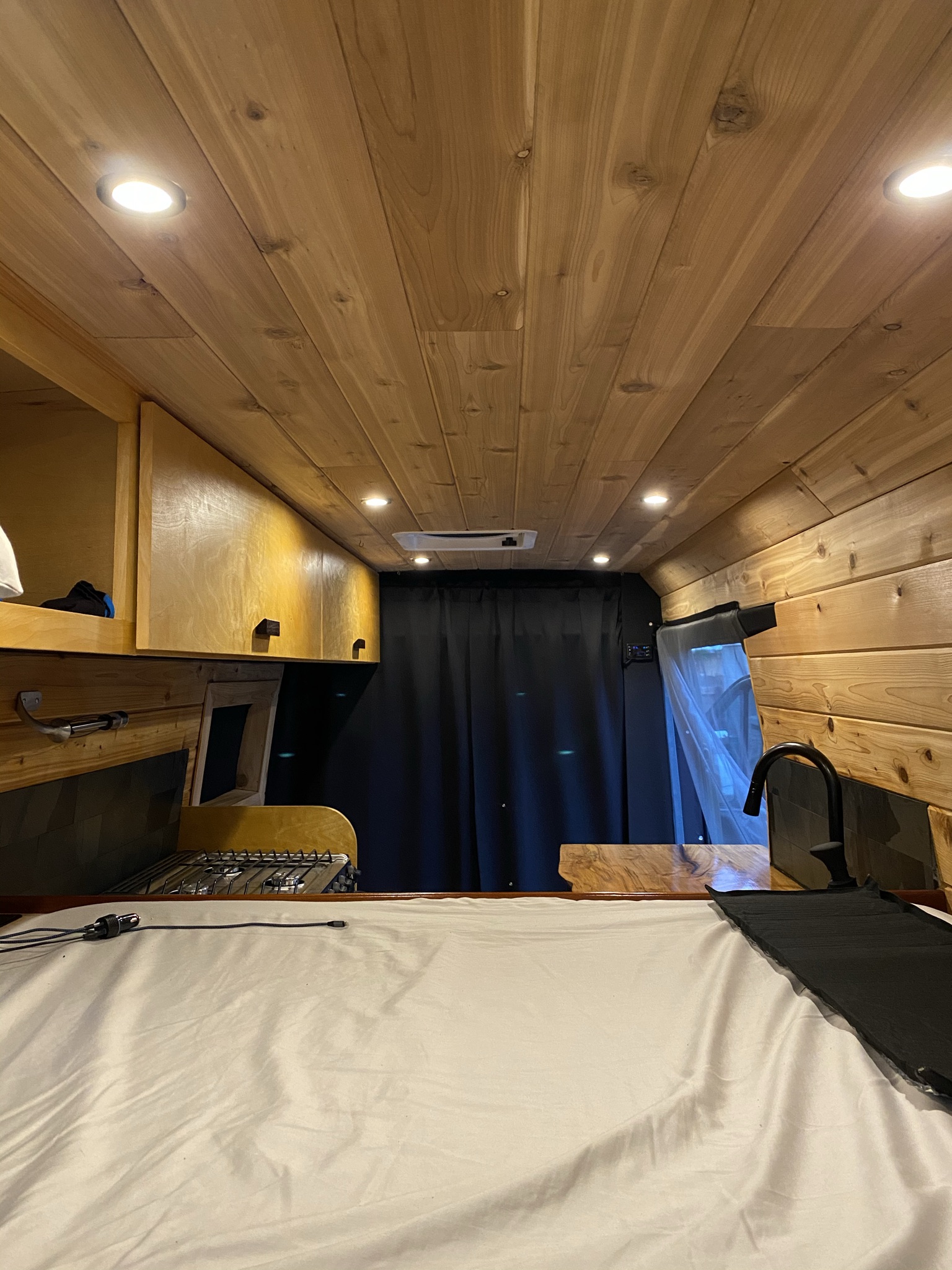

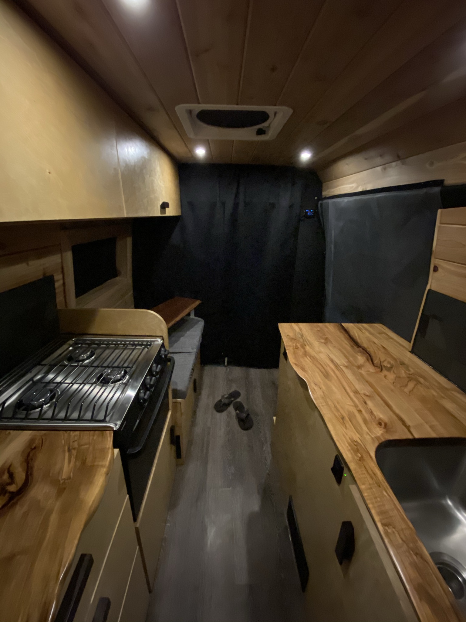

Woodworking/Build
-The counter tops are Ambrosia Maple that I did multiple coats of penetrating epoxy because the Ambrosia Maple can be soft in the sap wood parts.Then coated them with Odies Oil.
-Walls/Ceiling are Tongue & Groove Cedar
-BackSplash is real slate tiles left over from a job I did. I glued them with Loctite PL3 onto a piece of roughly sand 1/2' plywood I also used no grout for no cracking.
-Laguna Table is black walnut also coated with penetrating epoxy (since I had it and it completely seals the wood) then followed with Odies Oil.
-Cabinetry is cabinet grade maple plywood all edge banded and coated with Odies Oil. With Peruvian Walnut Pulls.
-Almost every part of framing I used was plywood since there is no movement with climate change and I could easily custom sized square straight pieces. Mostly all Kreg screwed together with Titebond 3.
-The Entire Van with a full water tank and gas tank weighs 7500lbs which I think is pretty good given the amount of hardwoods I used.
Appliances:
-Dometic Stove/Oven. Fueled by a 20lb propane tank under it in a sealed and vented box. Tank has a solenoid valve with switch next to stove.
-Fridge/Freezer is a IceCo 68qt dual zone.
-MaxxAir Fan
-6 Led Lights on a dimmer
-2 Led bars in garage area
-Diesel Heater Under Passenger Seat
-Composting Toilet under Bench seat
-Pull out Shower Under bench as well
-Bed is custom cut High Density Foam, It has full size sheets on it and a full size mattress would fit. I did the foam because I wanted the head room and like a firm mattress.
