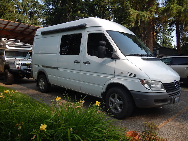

Since our Earthroamer XV-JP has an ARB 2500 x 2500 awning with a slide on screen room, it just made sense for the Sprinter have the screen room option... Mounting was simple straight though bolting... The vertical positioning of the awning had to have the slide in screen room slot just below the roof gutter line, but not low enough to interfere with the sliding side door...
I'll post photos of the awning extended and with the slide in screen room attached later...
