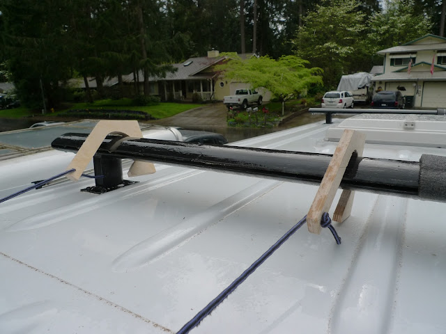

(above) The plan is to hook the ladder over my roof racks...Plywood is the easiest way for me to fab most things...Here are the rack hooks...
(above) Major assembly done...
(above) With the nylon cords, it super easy to adjust the overall length...As it is, it is an eight foot ladder...
I can reach the roof rack (barely) standing at the rear door and on my tip toes...The plywood hooks get dropped over and there it is...Roof ladder...
Hooks over rack...

(above) Up top, a 3/8" nylon rope keeps the chain off the metal and is knotted to the chain and the plywood rack hooks...
(above) The rack hooks...I went up and down a half dozen times and I can say, it's solid and will get me up and down no problemo...
