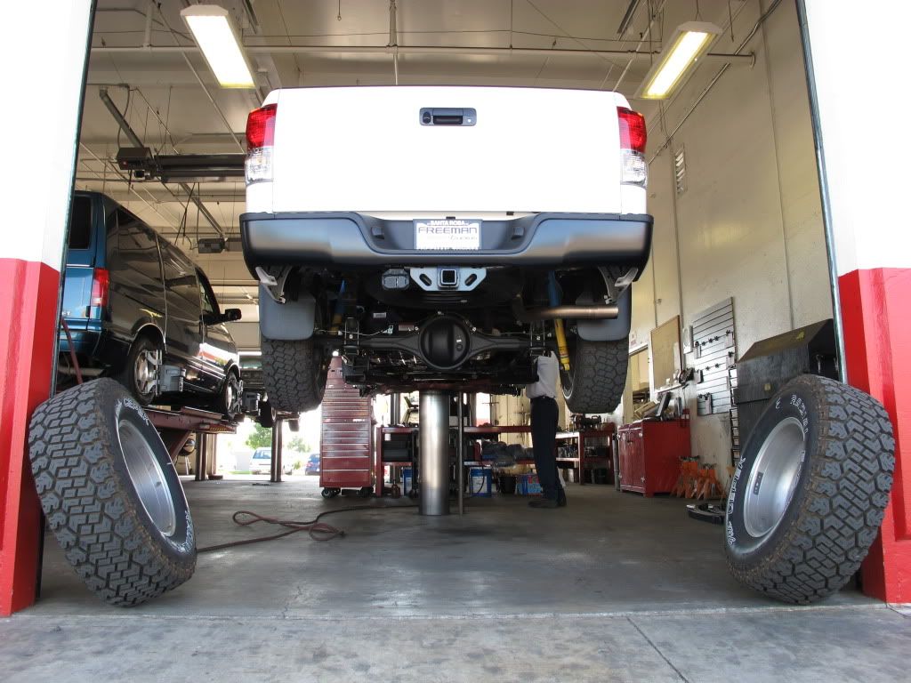

I've continued to study almost every option and combination. From OME, to adjustable coil-overs, rear air-springs, heavy front bumpers w/ a 12k winch, no front bumper and adding a rear bumper, a grille guard/winch mount instead of a front bumper, a front hitch receiver and, and, and............ I've been up late more than one night and lost plenty of sleep, it's been fun :)
Yesterday and again today I did my initial towing break-in of the gears on the truck. Towing a 30-foot, 8,000-lb travel trailer is a different kind of overland duty, but one this truck needs to do well or it will be fired. While I like a soft ride when unladen, soft ride springs and heavy work are usually at odds. Hauling and towing heavy loads is part of the mission. Even completely stock with no added weight, it was immediately clear that the Tundra could use more spring rate both front & rear to help control and stabilize loads, the front might be more difficult than the rear.
My baseline towing tests suggest that the OME suspension is probably a very good choice for my intended use. If I continue in this direction the big decision in the coming weeks will be 1) whether to get the regular 612 springs for the front (and not add a bumper and winch immediately) or the 613 coils, which mean adding a bumper 2) adding the rear Dakar springs for the lift and firmness they will add for loading, or just go with a rear 1.5" block and air-springs for the loads in the rear.
The air springs are an option with or without the Dakar springs. The air kits are actually less money that the leaf springs. And while I know I will eventually make more modifications to this truck, I've been seriously considering taking things slower than initially planned. Not drilling the frame to add the air spring brackets and not ripping off the stock bumper to add a big bumper and winch (and lots of weight) to this one month old truck is seriously being considered. Must be something in the water, this is not normal thinking. But once 250-350# of bumper and winch are added to the nose it will be difficult to go back.

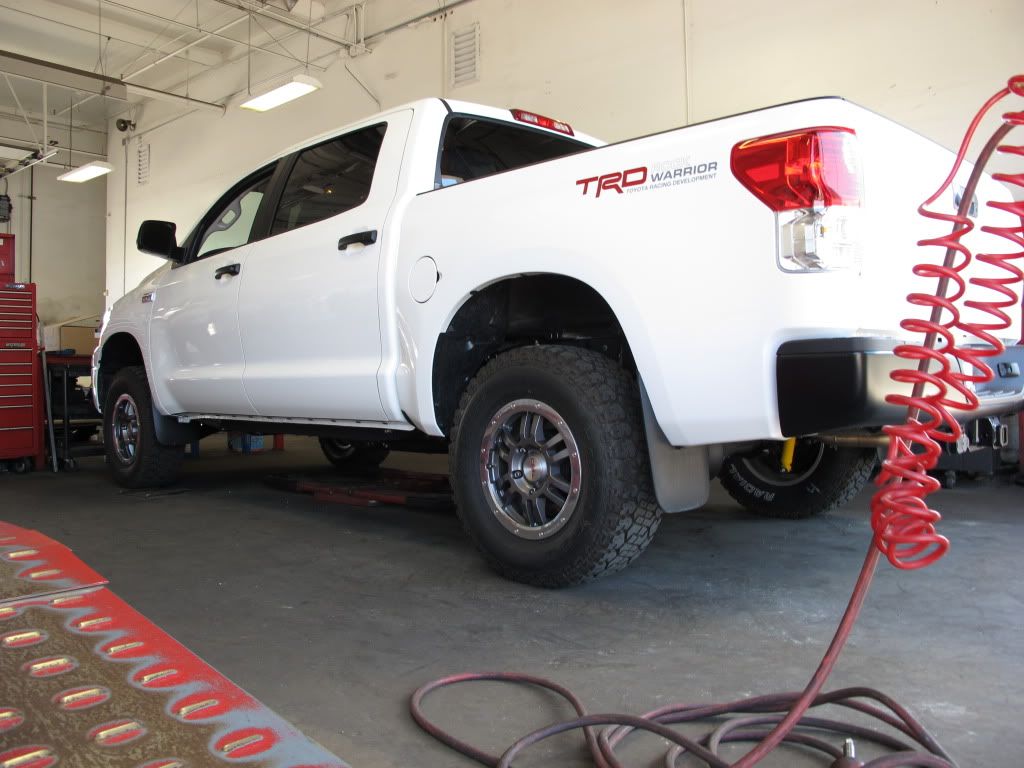

I came very close to buying adjustable coil-overs for the Tundra, but decided to use OME suspension instead. The Tundra needed new springs in both front and rear and OME seemed to have the best overall package regardless for price.
Freshly lifted and on the ground for the first time.

Lookin good for a garage truck. How 'bout some pics in the dirt:sombrero:
btw- i still havent done anything about my bumper.
Yes, I need to get out and do some post lift dirt testing and photography, soon I hope.
I'm not completely finished playing with the suspension, I plan to add a 1/2" spacer to the left-front to help with the driver's side sag, maybe next week.
