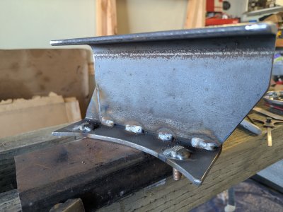

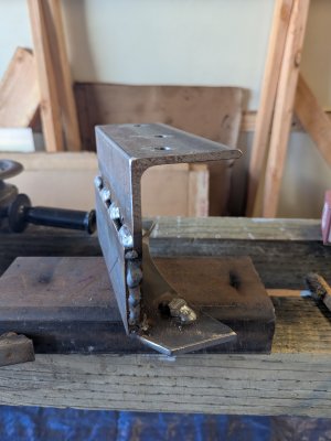

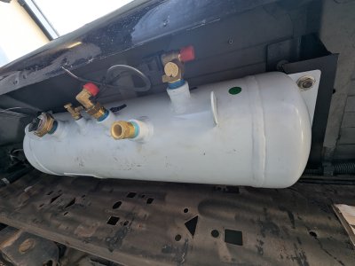

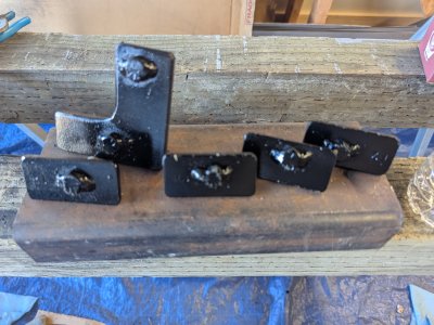

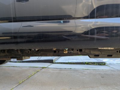

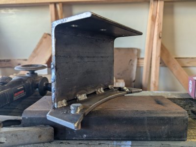

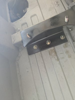

Finished up the brackets to mount the propane tank under the driver side rocker area. Tucked up nicely and other than the pressure relief valve, you cannot see it from the side. Very happy how this turned out and just need a jack and remove 4 nuts if need to service. I was using metal I already had, which is why it's 1/4" angle iron. 😂
