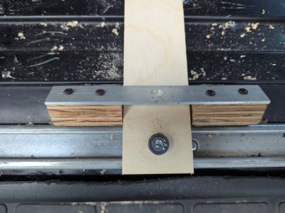

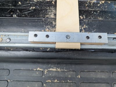

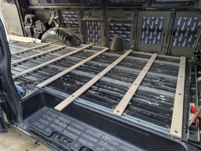

Then I was able to get the cross slat pieces mocked up for the sub floor (I need to cut the one piece). I still need to countersink the screw holes and then cut all of the pieces that will install between the cross slats, on top of the Unistrut. This will basically make a grid patter for the ply sheet to mount to. I have 1/2" insulation that will go on the floor, under these slats, then will install 1/2" insulation between the open parts of the grid. Then ply over that. Should work out well. I made a jig that helped me drill holes in the correct location on the slats.

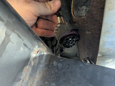

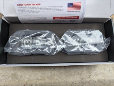

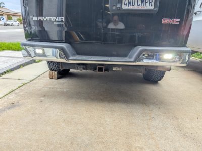

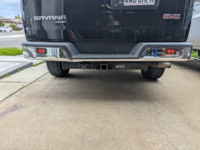

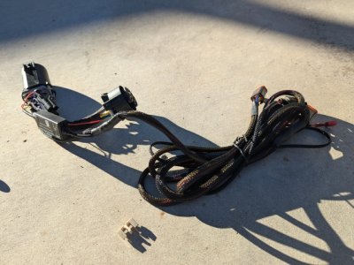

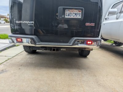

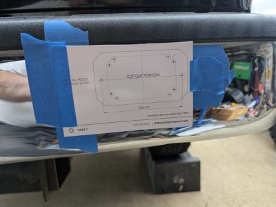

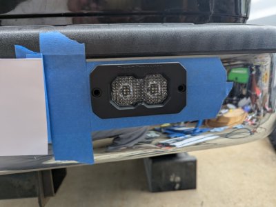

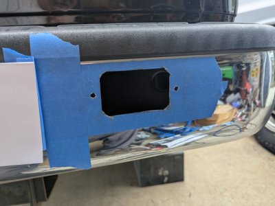

Well between being sick and then rain, I haven't been able to get much done. I did get a set of Diode Dynamics SS2 C2R flush mount lights for X-mas. I had also picked up a plug and play dual light harness from them, that plugs into the factory trailer wiring. I think I had less than 2 hours total into the full install and works great! Now I can have some decent backup lights, along with running and brake lights (that have an initial hyperflash).
Running lights
Brake lights
Backup lights

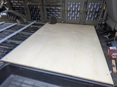

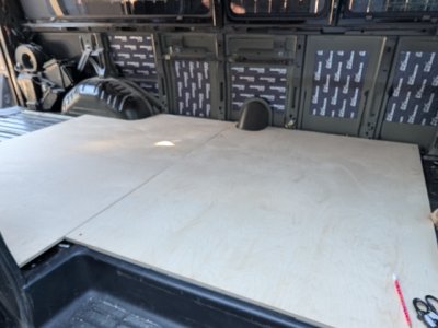

Got some free time to get some more of the floor work done. Got short slats cut, drilled and all of them painted. Still need to do more short slat for the middle section. Was able to get the front and middle top sheet cut and test fitted. Very happy with how this is coming out. I still need to troubleshoot the rear HVAC and see if I can get it working. I need to know if I am keeping it or removing it before I can finish up the rear part, since it will effect how wide I make the back piece.

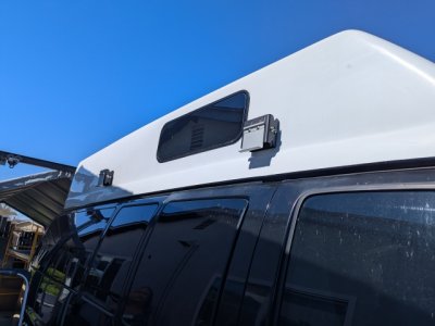

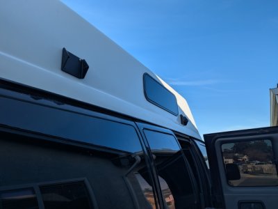

Got some time this weekend to tackle another project (well everything mocked up, I need to do the final sealant and lock-tite of hardware). I used a set of High Top Vans awning brackets and got my Fiamma F45s awning installed. I pulled this off my M1010 ambo project once I knew I was selling that, as I knew I wanted to move it over to the van. Overall the install went very well and the brackets work great. Lots of adjustability to them.
