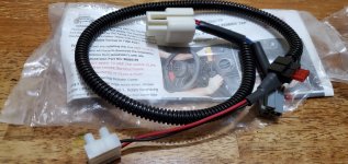

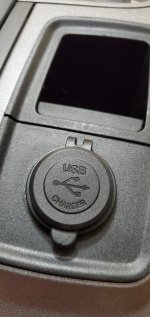

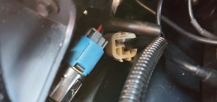

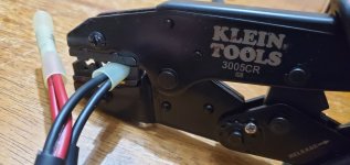

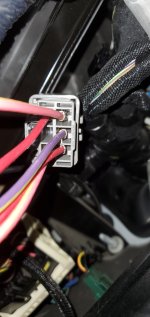

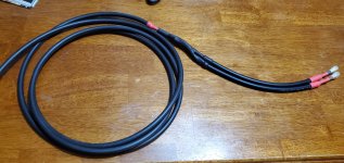

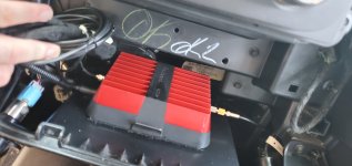

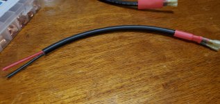

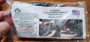

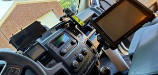

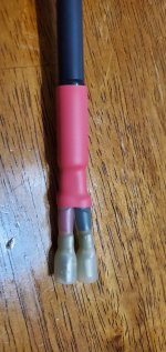

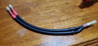

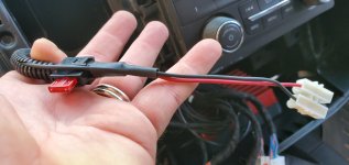

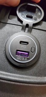

Just finished installing Expedition Essentials RAMPAM, and relocating my cell booster into the dash where there is plenty of room. I wired all 4 of the 83 watt each outlets, (USB 3.0 and USB-C wattage combined) into my upfitter wiring, with the fitted 40amp fuse. And the RAMPAM I used an old JK wiring plug that's the same plugs as my truck to add power to it, instead of tapping the wires. To me this is a more complete solution. This has definitely helped get to a more permanent solution for the phones, and other items we bring along with us during travels. I'm happy with it, and the fact that that the booster is out of our way now as well.

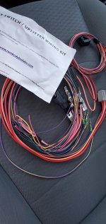

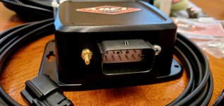

And, after a couple emails, he will be building me one that I can simply hook up to power and ground, then I can control all functions of an AAM front and rear locker, as well as a PW sway bar, while using the factory PW dash controls in my cummins truck with the manual 44-47 transfer case.
I've started putting the parts together. I already have front and rear AAM 4.44 gears, PN# AAM-D925444GS for the front, AAM-40116812 for the rear. and I today purchased the front Tru-Lock control switch PN# P68142283AF, and the Abel Components Full Bypass system, that includes a sway bar motor actuator.
I still need the front and rear lockers, as well as a sway bar, (no motor needed). Then I'll get an install kit for the bearings and seals. If anyone ends up seeing anything for a good price, please let me know. I have time, so I'm hopeful to score some decent deals between now and the winter time project.

Some of the parts have come in. The electronics side of this whole deal is going to be sick! VERY simple, and the actuation will be immediate with no fussing with control nannies. Simply lock, unlock, or attach sway, or detach. All using the factory Power Wagon controller. And Abel Components knocked this out of the park. OEM quality all around here. 👏

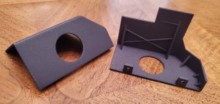

Also, the rear 12v plug extensions I had 3D printed from a guy on Ram Forum came in. He did an EXCELLENT job on the design of these. Can't wait to get them in along with the harness I made for them.
