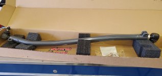

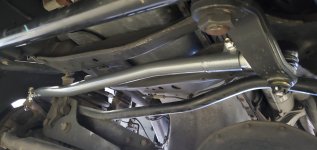

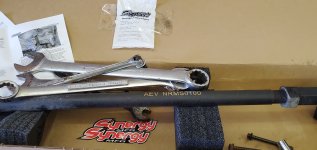

We are getting ready to head to Arkansas for a week in the Ozarks. Looking forward to a good break. But before we leave, I've been needing to swap this drag link out. Ended up going with a Synergy due to the bends as it was the closest to the and AEV. The AEV made it 6yrs and 80k miles, here's to another 6 or more hopefully!
I would be interested in hearing why you didn't just replace it with another AEV component? I am guessing the prices were similar.
The Synergy was definitely more in cost. It's just a much better design on the adjuster. AEV uses the OEM Ram adjustment which has been recalled, including mine which AEV recommend the Ram fix which was welding the adjustment and the adjustment nuts together, which IMO is NOT a fix as it then makes it a non-adjustable drag link.
Also these rod ends are much beefier, and I can now only replace ends as needed. The bar itself is a lifetime product. Not an option with AEV. The bar just has more ingenuity and strength built in, as well as thought for future maintenance and replacement cost.
