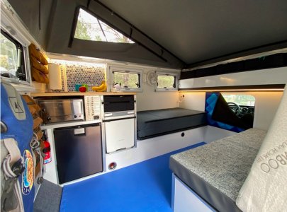

Habitat Specs
  • Habitat exterior Dimensions: 93.25″ long, 73.875″ wide, and 57.25″ tall (with pop-top down)
  • Habitat interior height: 54.5″ tall with pop-top down, and ~7’ 4” tall (in back) with pop-top up
  • Habitat interior width: 72″ wide
  • 24” x 19.5” passthrough into cab (with insulated Velcro attached cover)
  • Side walls: 0.8” carbon fiber Urethane FR-3704.5 foam sandwich panel (R3.5)
  • The ceiling/roof and passthrough wall: 0.8” carbon fiber Divinycell H45 foam sandwich panel (R4.5)
  • Floor and aft wall: 25mm thick fiberglass composite polypropylene honeycomb sandwich panel
  • Habitat internal frame: TIG welded steel frame with full coverage gloss white powdercoat
  • Structural assembly adhesive:
  • Kommerling Korapop 225 (using Sika Aktivator-205 and Sika Aktivator-100)
  • ProSet LAM-125/224, ProSet LAM-135/224, and West 105/205
  • Pop-top:
    • Front hinge wedge style pop-top
    • Cloth: Top Notch 9 Charcoal Fabric
    • Screens: No-See-Um Performance Mosquito Netting, Black
    • Zippers: Lenzip #10 Black Separating Molded Tooth Zipper
    • Lift: Two gas struts, 33 inch long, 50lb/68lb, McMaster Carr 4138T621
    • Latches: Stainless steel latches from Ursa Minor Campers
  • Windows:
    • Arctic Tern Overland Euro-style double glazed windows
    • 3 windows above bed, 300x500mm (with integrated blinds and screens)
    • 1 window in back wall, 300x500mm (with integrated blind and screen)
  • Door: Arctic Tern Overland Wildlands door with screen + insulation kit
  • Marine grade latching cargo hatch in forward floor of habitat for underfloor storage
  • Recovery: Two MAXTRAX MKII recovery tracks (black) mounted to back of habitat (with locks)
  • Slide out steel entry ladder under camper entry door (modified Mytee Ladder-2R)
  • LED marker lights and reflectors in all DOT required locations on exterior of habitat
Habitat Interior
  • Entry flooring: grid rubber mat floor “mudroom” with drain just inside entry door
  • Flooring: Interlocking blue foam gym mat
  • Accessories: Fire extinguisher, mirror, and paper towel rack
  • Oven: Travel Buddy 12V oven (with shelf and non-stick pan)
  • Sink: Stainless steel sink (12.75" long, 7" wide, and 4" deep) with standard 2.5” “bar style” drain
  • Gray water: Sink drains to ground (can retain about 0.5 liters of water by closing under sink ball valve)
  • Faucet: Pump faucet (Whale GP0418 Flipper Pump Mk 4 Hand-Operated Galley Water Pump)
  • Composite kitchen countertop (Mil spec birch plywood and aircraft grade foam core)
  • Refrigerator: DOMETIC CoolMatic CRX 0050T PRO, 46L with 4.4L of Optional Freezer Space
  • Bed:
    • Modified HEST 3.9” Dually memory foam mattress
    • Mattress folds into two bench seats for “day mode” (easily sits 4 people or a cozy 6 people)
    • Mattress size 50” x 72” (I am 6’2” tall, and it fits my wife and I well)
    • Bed platform is carbon fiber and aircraft grade foam sandwich panel
    • Plenty of headroom to sit in bed with pop-top down (very cozy with top down in bad weather)
  • Fan: Caframo Sirocco II fan over bed
  • Two 115V power outlets
  • Three USB outlets (two USB sockets each)
Habitat Interior Lighting
  • LED lighting throughout habitat interior
  • LED strip light over kitchen counter
  • LED strip interior entry light
  • LED strip over bed (top of passthrough wall)
  • Exterior LED light underneath rear of habitat
Habitat Electrical System
  • Solar:
    • 525 Watts solar panels on roof of habitat
    • Three Renogy 175W, 12V, flexible monocrystalline panel (wired in series)
    • Solar panels are fuse protected
    • O-ring sealed MC4 power connectors throughout
    • Blue Sea SE7 Side entry waterproof cable gland on roof
  • Victron solar charge controller (MPPT 75/15)
  • Breaker/cutoff switches: Solar, invertor, and main power
  • Batteries: Three 100 Ahr Battleborn Lithium Iron Phosphate batteries (300 amp-hours total)
  • Battery monitor: Victron battery monitoring system (Bluetooth capable BMV-207 Monitor)
  • 10 circuit distribution panel
  • All aircraft grade circuit switches and breakers
  • Inverter: Renogy 1,000W pure sine wave inverter (with remote control pad)
