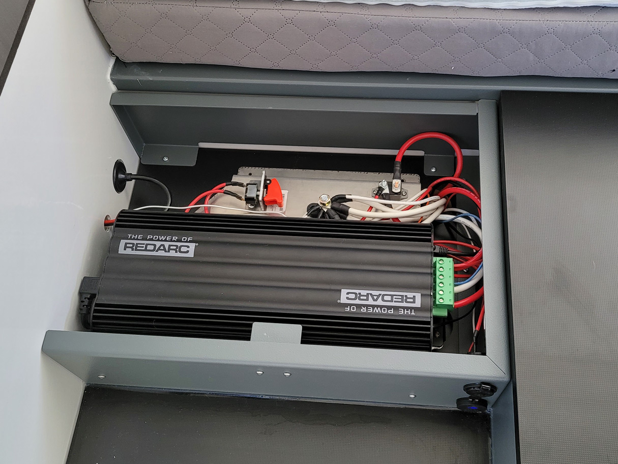

Like the REDARC being in the box on top of the counter

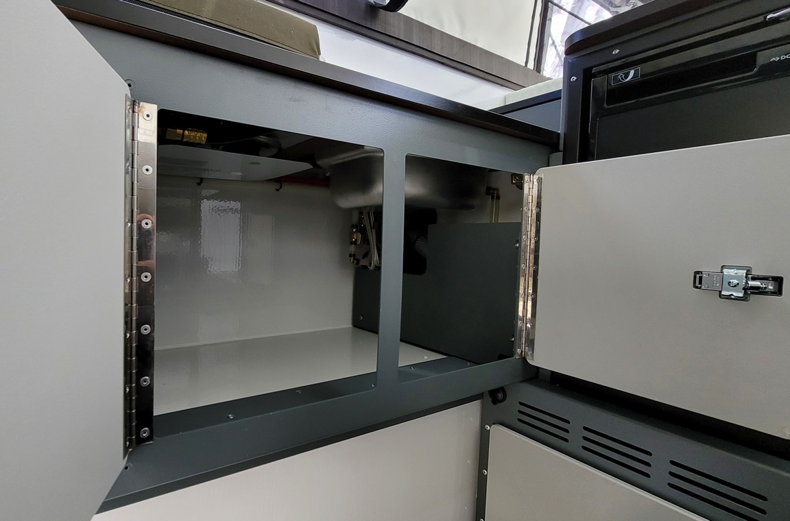

images of under the sink and the under-sink cabinet openings (my 2020 right side is blocked by an outlet and breaker box) and how the shorter wider propane compartment pushes into the undersink area,

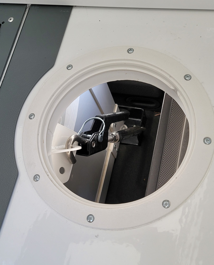

pics of the front two turnbuckle ports (are they now insulated doors or are they still the screw-off marine ports?), etc.
Right side is a screw off marine port:
Left side is an insulated lockable door.

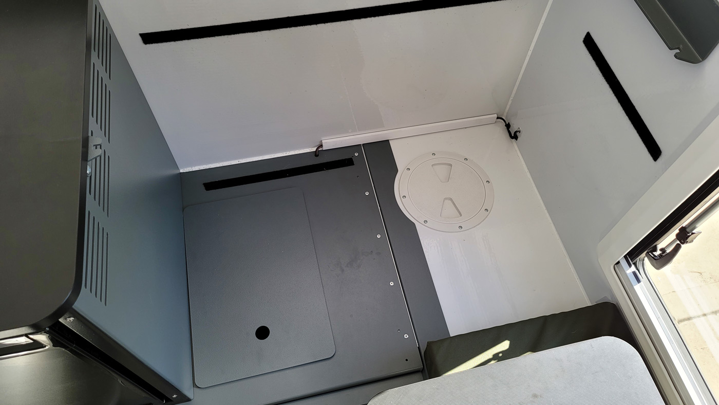

Also, is your dinette floor aluminum or composite panel?
My dinette floor is ice cold aluminum :-)

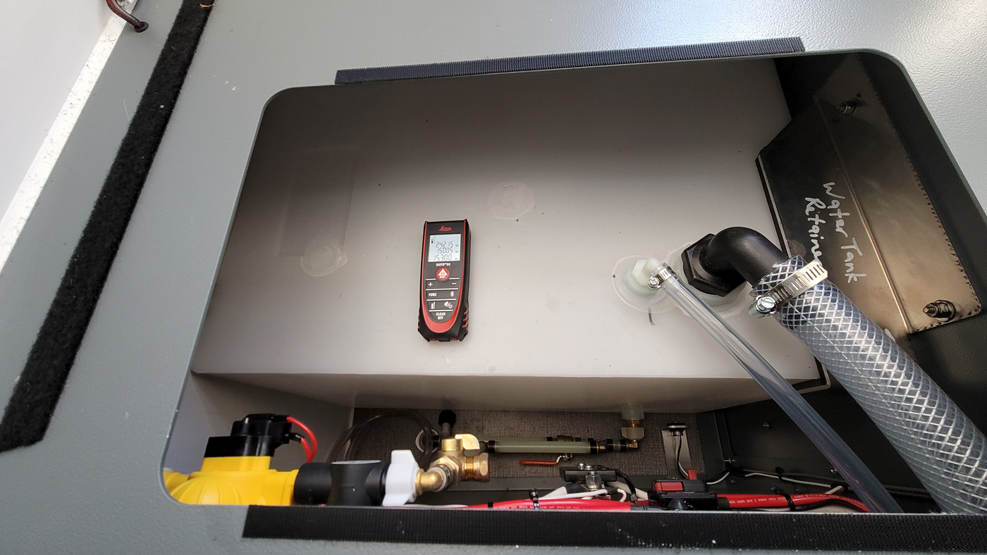

Here's the water tank area
The water tank appears to measure 24.215" x 15" x 15"

I love how much room and how accessible the undersink area is with the 2021 and 2022 updates. And if one wanted to replace the sink with a larger/deeper unit with separate faucet, looks like there is plenty of room. And now all the plumbing is run at the top of that compartment so the entire cabinet floor is useable. In my 2020, the pipes run along the floor at the rear of the cabinet and so I had to protect them from containers and the cabinet floor space less useable. Little but constant improvements that just keep improving the usefulness.
Regarding the REDARC, I saw a video a long time ago with the reasoning behind the red trigger. I see that in your picture and noted it in the images I did in the CAMP-HBE thread, but I don't recall it's function. Seems it was something to do with a reset, but I don't know what would ever need a reset with a REDARC, so perhaps that memory is incorrect. Anyone know?
"The water tank appears to measure 24.215" x 15" x 15". "
I cracked up at that comment. Love the precision. So that calculates to 5448.375 cu inches divided by 231 gives approximately 23.58603896103896 gallons of water (not that one would fill all the way to the top of the tank plus that is outside measurement, so actual capacity is a gallon or so less if one subtracts about 0.2" from each dimension. The advertised 20 gallon seems a reasonable size for them to spec.
They explain it's a momentary switch to fool the REDARC into reading the voltage in your truck battery..
Skip to 7:30 into the video
Thanks. That's the vid. The description is still kind of confusing, but listening to it several times, it sounds like it for more than reading voltage of the pickup battery. They mention it causing the REDARC to "see" the pickup battery voltage and that the house battery will start to charge (which it typically doesn't do unless the pickup is running and so the voltage is high enough to trigger and charge). That makes it sound like the house battery will start to draw from the pickup battery when the pickup isn't running and convert that voltage/amp to a voltage/amp that will charge the house battery. There are also disconnect voltage/SOC settings in the REDARC they could be talking about. Or perhaps, related to lithium running down too low and BMS disconnecting and the REDARC not seeing the battery and wanting to trick the REDARC to sending current to wake up the lithium and reconnect BMS. I'm going to reach out to Arnold as it's not clear from that video. I'll share response.
Clarification from Arnold on the momentary switch and in what situation one would need to use it.
"The momentary switch:
If the house battery is drawn down below an acceptable voltage as seen by the Redarc. The owner can use the momentary switch to satisfy/trick the Redarc into seeing an acceptable voltage from the truck battery, the Redarc will then allow the house battery to charge by solar first (if it sees available power coming from it a min 9V’s), if not, then shore power, if not and then the alternator. The Redarc always defaults to solar as a source of power first and then whatever else it can find in its absence. It will not charge frrm your truck battery, it needs to see the alternator power.
This will also trick the Redarc in the event the BMS trips with a lithium.
W/O the momentary switch, in a low voltage house battery situation the owner would have to remove the battery and charge it."
So, my take on this...
This is primarily for a situation where you have your REDARC set to cut off at a certain voltage or certain state of charge (you should have the REDARC set to first send you a warning so you have time to reactive before it disconnects).
If your house battery has disconnected, you may not be able to go into the REDARC settings to lower them and get it all reconnected. So, having this momentary switch is a way of resetting the REDARC rather than disconnecting it, charging the battery with some other means, reconnecting it, or any of that. Simply ensure you have an active charging source connected to the REDARC (Solar, shore power, or running pickup engine/alternator), reset the REDARC using the momentary switch, and the REDARC will reconnect and start charging your battery.
Regarding that last line of "the owner would have to remove the battery and charge it." to reset a LiFePO4 BMS, I don't think one would have to physically remove the house battery, but one would definitely need to use a Lithium compatible charger to "wake up" the lithium battery BMS. Some smart chargers won't do that because they will only start to send charge if they detect voltage above a certain threshold and that won't be there is you BMS trips (due to being discharged, below freezing temps, etc.) Sounds like REDARC switch will also get the REDARC to send current to a "BMS disconnected" lithium battery and so wake up the BMS.
One thought of caution, that should be tested/confirmed, is if the REDARC would send current when the temp is below freezing and in lithium setting. But then, the lithium battery shouldn't reconnect if it's internal temp sensor is below freezing. AGM have no such internal sensor and one should NEVER charge any lead acid battery that is both dead and below freezing. This because, unlike a charged lead acid battery, a dead lead acid battery will physically freeze. So if using this momentary switch to force a REDARC to send current to an AGM battery that is dead or low voltage, make certain it is not below freezing/frozen. The temp at which a lead acid battery can freeze changes with the voltage, so a battery can freeze even if not completely dead and simply has low voltage. So please use caution in any situation where an AGM (or any lead acid battery) is discharged and in below freezing temps.
