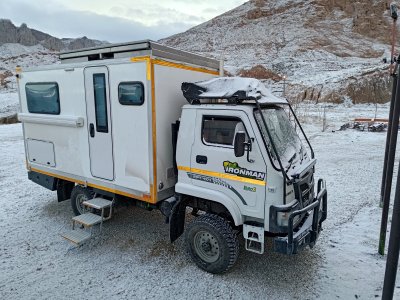

Built in 2021 on the Sammitr MPT 4x4 platform with a custom fibreglass habitation box, the truck was designed from the ground up as a fully electric expedition vehicle — no gas bottles, no propane. Everything is powered by 1,600W of bifacial solar and a 24V LiFePO4 battery bank, with a Victron electrical system. The entire truck is controlled via Home Assistant. A diesel heater was the one practical concession after real-world testing at -15°C in Scandinavia.
This is the only one of its kind in Europe. Selling because our family is growing and we've run out of seats.
Instagram (travel photos): @all.out.phoenix

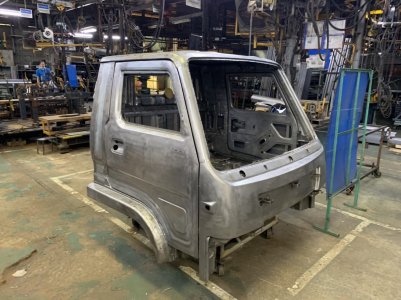

The cab is a custom, extended model with 150mm of additional length compared to the standard. Fitted with an integrated bull bar, brush bar, and cab roof rack that extends down each side of the windscreen. A custom crane is mounted on the cab roof rack for lifting the spare tyre.
Suspension upgraded with 4 x Ironman 4x4 shock absorbers. Tyres: Linglong Crosswind M/T (front + spare), Hankook Dynapro MT10 (rear) on 5.5 x 16" steel wheels. 230mm ground clearance, 6m turning radius.
~40,000 km. Route: Thailand → Malaysia → Pakistan → Iran → Turkey → Bulgaria → Europe (including Scandinavia x2).

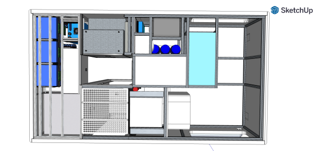

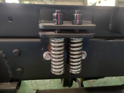

The box is mounted on a separate subframe with isolation mounts between the box and the chassis.
Interior dimensions: approximately 2,000mm wide x 2,000mm tall x 3,600mm long.

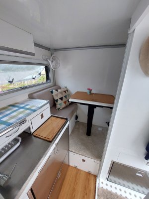

Bedroom: King-sized bed spanning the full width at the rear with a Thai 100% natural latex mattress. Skylight above. Large windows on both sides. Under-bed storage accessible via rear exterior hatches. Cabinets along the rear wall. Projector and screen for entertainment.
Kitchen: Induction stovetop, sink, and Isotherm Double Drawer 160 stainless steel fridge (5.5 cu. ft., AC/DC, flush mount). Kitchen benchtop with upper cabinets. Long, narrow window above for natural light.
Dining/seating: Bench seating with a sliding table that adjusts left/right and up/down. The table lowers fully, and the back cushions lie flat to create a single third bed.

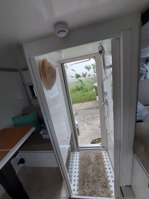

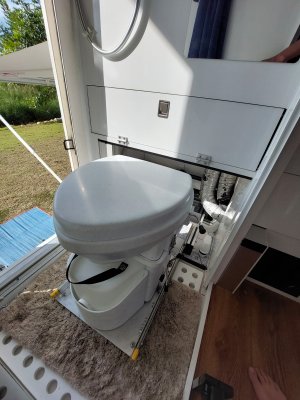

Bathroom: Shower enclosure, Nature's Head composting toilet, NCE wall-mounted washer/dryer combo. Isotherm freezer also located in this area.
Entry: Door on the left side with flyscreen. Exterior luggage doors on both sides for under-floor storage.

2021 Sammitr MPT 4x4 Multi-Purpose Truck. 2,771cc 4-cylinder turbo diesel with intercooler, 102 HP, 240 Nm torque. 5-speed manual gearbox with part-time 4x4 and dual-range transfer case (2H/4H/2L/4L). 5,000 kg GVW. Power-assisted steering. 80L fuel tank.The cab is a custom, extended model with 150mm of additional length compared to the standard. Fitted with an integrated bull bar, brush bar, and cab roof rack that extends down each side of the windscreen. A custom crane is mounted on the cab roof rack for lifting the spare tyre.

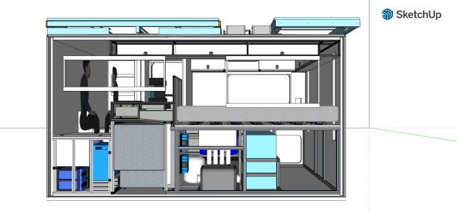

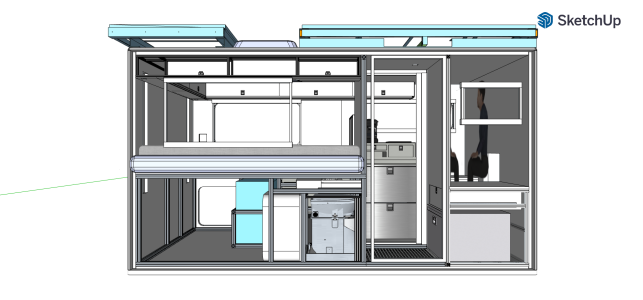

Custom-built fibreglass (GRP) sandwich panel habitation box, manufactured in Thailand. GRP on both sides with ArmaForm Eco core insulation by Armacell. Walls and roof are 55mm thick; floor is 75mm thick. Interior panels are CNC-cut Plastwood composite boards.The box is mounted on a separate subframe with isolation mounts between the box and the chassis.

- Full engineering drawings and CAD files for the box (4 revisions, STEP/STL/DWG/SKP)
- Wiring diagrams, plumbing diagrams, supplier manuals, and solar panel datasheets
